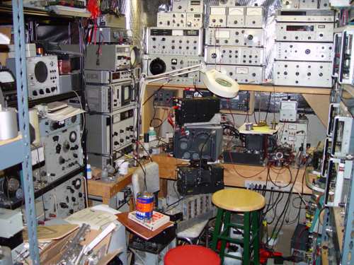

A big congrats Jim on getting her up and running.
BTW - Nice shop. It looks as clean as mine... Wink

Also, I'm thinking about what I can do about the cables. It seems that where the armored part of the sheath connects to the head assy has separated leaving the wire harness exposed. The connection point to the head is similar to a liquid tight connector but, of course, different dimensions. Is there any way, short of desoldering the wires and shortening the harness, to "pretty-up" this mess?
As John said, nope. If you'll send me the exact outside diameter of the flexible conduit, I'll whip out a new ferrule for it on the lathe. I use a modified tubing cutter with a radiused edge on the rollers to roll a new crimp onto the ones I make for the WWII radios, but I think some epoxy will do fine for you.
Your workshop needs some serious reorganization. You can use mine as a model:
I will admit that I'm running out of stools and chairs to set DUTs on, but the ARR-7 was a fine spacer for the ARC-5 transmitter I was measuring antenna feedpoint impedance on... Confused
- Mike KC4TOS

Usually, there's two or three jobs sitting on the bench but lately things have been kinda slow. A Philco BOL TT is sitting on the wing bench waiting for a new photocell ( on order) . My bench is an "L" shaped affair...12' for the wing and the main bench including the lathe is 14'.
But what you don't see are the 40 or so BA's behind me.
