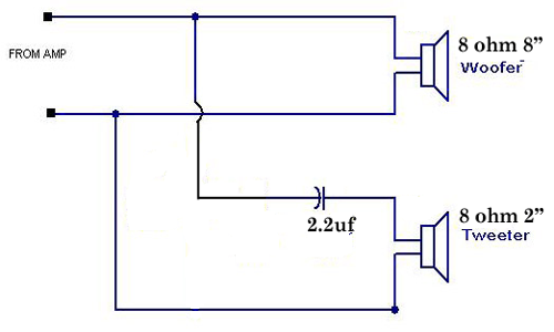

So how the heck can I get a real definitive test to determine optimum settings for load impedance?
Is there a way to measure power/efficiency or whatever?
Will the scope see a difference on the plate voltage in the PP amplitude with different taps? ( using a 400hz test tone)
I'm using a couple of ole 1970's stereo speakers.
8 ohms.
Iinside there's an 8" woofer in parallel with a 2.2uf cap to a 2" tweeter.
This is supposed to "crossover" at around 7,000 hz. I believe.
(does that keep the impedance at 8 ohms like that?)
Does the cap as a crossover in there change the circuit to look like two 8 ohms in parallel = 4 ohms? or does it remain 8 ohms?
Update answer:
"The crossover allows you to place two 8 ohm speakers in parallel, one for the highs and one for the lows, and still present an 8 ohm, not a 4 ohm load to the amplifier (which is what the amp would see without the crossover network)"
Guess that answers that!
Anyway... The sound seems "darn good" too.... which-ever way it's tapped... lol
BTW ...("Darn good" is one of them there scientific terms.)

Not sure on the impedance of the two speakers with the 2.2 uf cap. I'll have to think on that. My gut tells me that the impedance will change a lot more than a single speaker would. Seems to me the net impedance would be less than 8 ohms for most frequencies, but I have no way of knowing the characteristics of the two speakers.

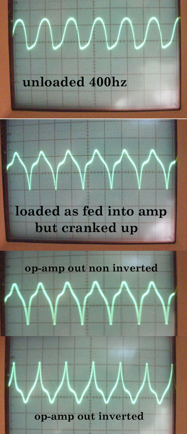

As far as feeding in my 400hz signal generator signal... then looking for distortion.... lol
My signal generator does produce a reasonably nice 400hz sine wave!.... until it's loaded feeding the amp.
Then it looks all weird.
It looks like some weird-looking waveform. So how can I see distortion? I have to compare weird to weird and hope I can see the exact areas if distorted.
Let me go take a few shots to show you.

Ok. here's the signal before being fed in.
Then it has to be cranked up or the input loads it down.
But then the signal is all weird-shaped.
And then the inverted and nonp-inverted op-amp out signals.

Well Those wave forms look good
you sure do nice photo taking Very Happy .
