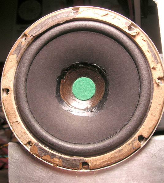

The speaker of my Philco 90 was in bad condition. The surround was very bristle and it fell easily into small pieces. The cone was better but had a small crease. I changed the surround. You can find new ones of many sizes in "Simply Speakers". They sell kits to repair speakers at very good prices. (https://plus38.safe-order.net/simplyspe ... eform.html). I would recommend to change the surround rather than treating the old one. As for the cone, Nick's method worked very well for me. I sprayed it with WD-40 and left it dry. Then I applied two layers of nail lacquer. For the creases and a small hole, I glued them, including two minute pieces that had fell off. Then I applied extra lacquer on the back of these weaker zones in order to seal the openings completely. The speaker works very well now and I feel that it is well protected. I would enclose a photograph but I do not know how to do it.
Manuela :)

At the risk of losing my Man Card for the week I stopped in Joann's (sp?) Fabrics and picked up both adhesives you recommended. The women in there hadn't seen a man in that store in about 3 weeks, so they were all too eager to help me out. I found the Sobo and the Fabri-Tac. Tried them both this evening on that Admiral. Man, I got to say what an improvement! That speaker was becoming one solid patch. Once I cut away the speaker cone from around the vc I could see why. It was so dry rotted that any vibration was just tearing it apart. I replaced the cone with the 5' from Electronics. I used the Sobo around the vc and the Fabri-Tac around the outer ring.
That Fabri-Tac stayed just tacky just long enough for me to jostle the cone around to ensure I wasn't rubbing any edges or anything. A couple quick checks with the radio turned back on for good measure confirmed that.
The original cardboard gasket helped ensure a good seal.
What a difference in sound. That original just sounded harsh, brittle with horribly distorted percussives, the replacement is nice and clean. I knew the original cone was too far gone for basic patches, but now I'm thinking of all those speakers that could use this treatment. I think it's a better looking repair than some of the spider webs of patches I've done in the past, although I would imagine that some of the real purists balk at the idea of swapping out the cones if at all possible. Then again, flip one of my radios over and count the orange drops.
Not a bad repair with a .39 replacement cone and a couple bottles of glue. Thank you again Peter and others that offered up their speaker tips.
