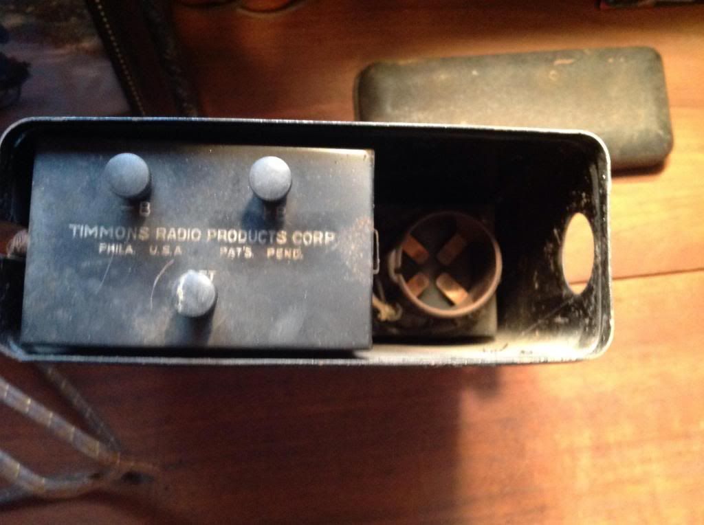

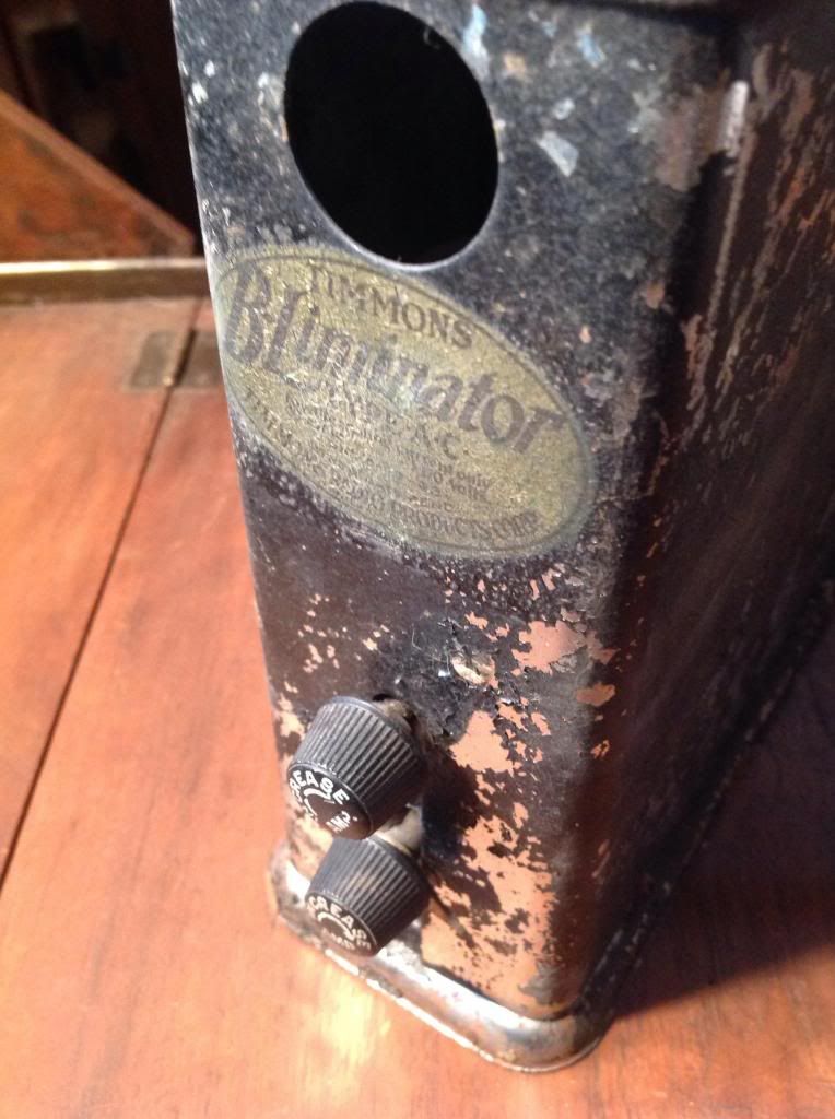

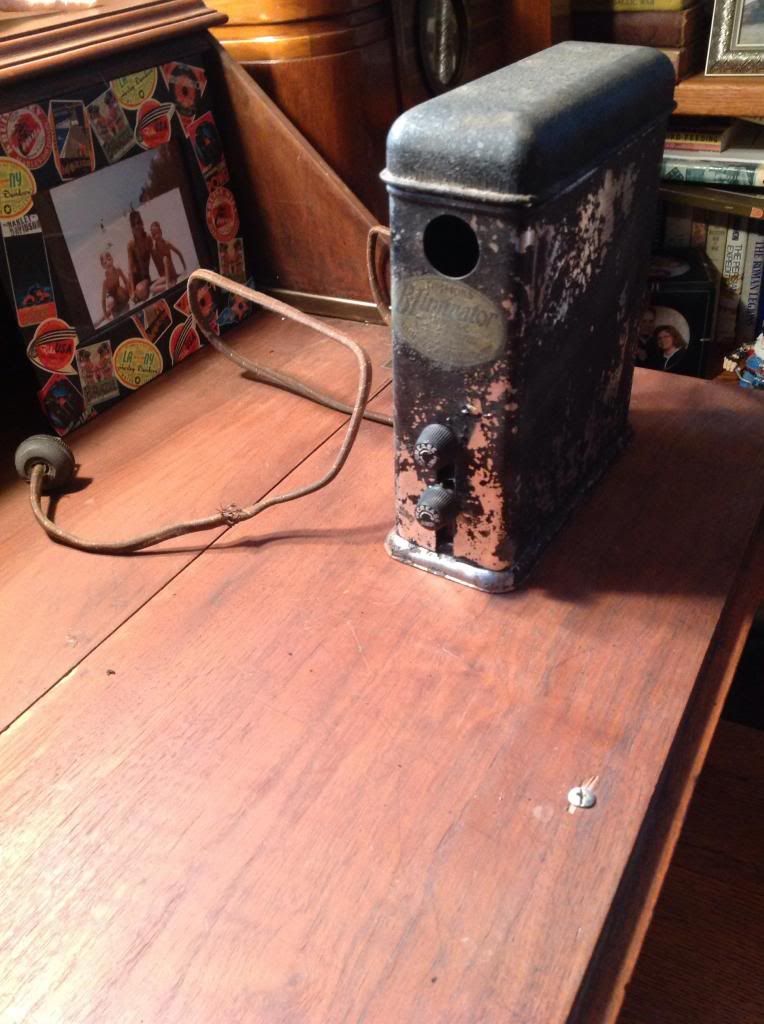

Interesting thread. I just located a Timmons B battery eliminator in a local antique shop. It had no price on it. It is complete without the tube and in good shape other then the paint is flaking off. What would be a good price for such an item in everyone's opinion? I may go back and pick it up to restore.
 Post subject: Re: 1920's "B" Battery Eliminator History
PostPosted: Feb Sat 01, 2014 10:01 pm
Joined: Sep Thu 06, 2012 6:00 pm
Posts: 744
Location: Kokomo, Indiana 46902
I was in town so I went for it and got the Timmons B-Liminator. A few pics. As it looks with nothing whatsoever done to it. 20 bucks.
If I can get it restored I'll use it with my 1925 Liberty 5 TRF.

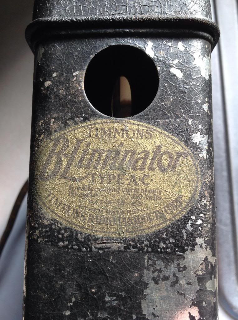

Take some good photos of the decal, just in case.
PostPosted: Feb Mon 03, 2014 2:15 am
Posts: 744
Good idea about the pics of the decal.
Does anyone have or know of a schematic for these? After opening it up the bottom wire wound rheostat was broken (the wire wound arc shaped piece just fell out) and the upper one, which is a different type, seems to be bad as well as the shaft simply unscrews from the body of the potentiometer. I'd like to get it working if possible.
PostPosted: Feb Wed 05, 2014 9:47 pm
Posts: 744
Once I have a " good as it can get" photo of the decal, how do you go about getting one reproduced?
Measures at 2 1/4" wide by 1 1/2" high and says ( top to bottom)
Timmons
B-Liminator
Type AC
For alternating current only
60 cycle - 110 volts
Pat. 6-15-23 (I think)
Other Pats Pend
Timmons Radio Products Corp
