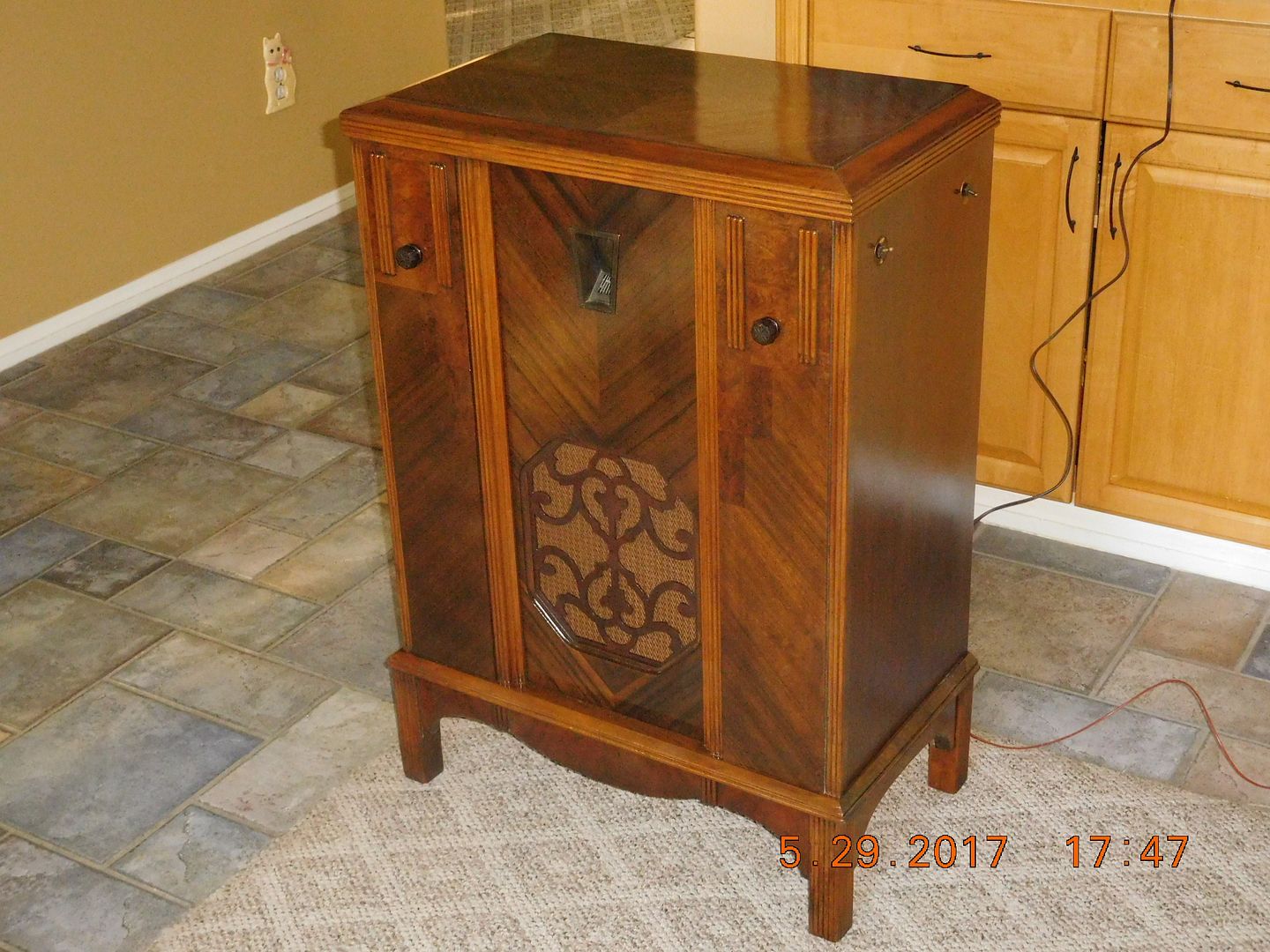

bobwilson1977 wrote:
As I have zero skills in woodwork, my wife who has lots of patience cut out a new piece for the grill using a box cutter blade. She then stained it for me. So now its installed in the aforementioned Pilot. I did refinish the damaged top and did some touch-ups in the areas where the finish was scuffed. New grill cloth as well. Its now totally done. The museum has decided they would like to sell this to me. Its perhaps one of my favorite radios and will be put in a prominent area of the living room. The sound on this is also rather fantastic.
Very nice! You wife must have steady hands. Barry Dagestino told me about a trophy and promotional items shop with a laser cutter. I had them re-make a grille for my Sentinel 11 / 104:
