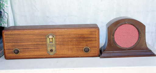

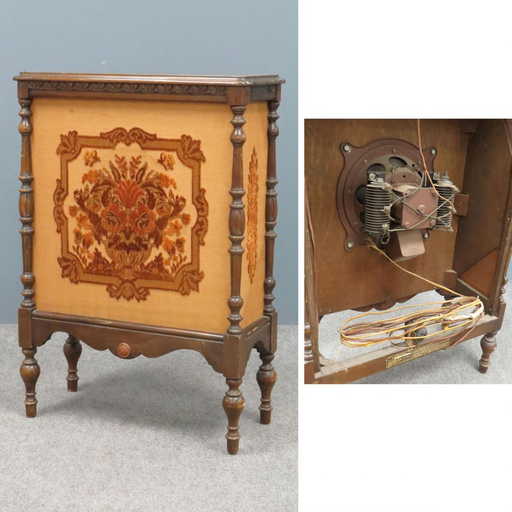

Is anyone familiar with the technical details of this Operadio (later DuKane) speaker?
Would it match pretty easily the output of the AR-936 or would I need to find a RCA or similar speaker to operate?
Both models were made in 1928.
A friend just found one of these 18's in nice shape, complete with "ST" tubes at a local thrift store and I've had the Operadio kicking around here as furniture for some time.
Not sure whether pot metal tuner is good, my friend will check before purchasing (or make a lower offer on it) if it's messed up.
Thanks all,
Kent

The Barcelona is an air column horn speaker. Impedance is probably around 1K.
The Radiola 18 connects it's speaker via coupling capacitor (0.5uf). The Radiola 18 should have no trouble driving the Operadio speaker.

Thanks Michael for the technical details, all I could find was the catalog page you posted, glad to find a use for the Barcelona :)
A gal just called from the hospice thrift store, had her check tuning capacitor ("turns smoothly") so I put receiver on hold ($49.95) for friends or myself to pick up in next few days...missing lamp hood, otherwise looks to be intact, have not seen underside yet and she said, "The store plugged it in, but nothing came on."
I had no idea this was such a common receiver from that era until looking into it yesterday, with a quarter million in production at that time, I'm surprised I've not come across it before.
Here's some photos my friend took of the Radiola at the thrift store yesterday and one I took of the venerable Barcelona this morning,
Seems this receiver is truly a "cross-country" unit, from N.J. to Portland, ME., possibly Lansing, MI.? and now Ukiah, CA.

If you want to be a little more "brand name" complete then you's probably match up that Radiols 18 with a Radiola 100-A speaker,...
Radiola 17 with Radiola 100-A speaker.
...or a Radiola 103 speaker,...
Radiola 60 with Radiola 103 speaker.
...or a Radiola 106 speaker.
You can also match up that Radiols 18 with a Radiola 100 speaker and a Radiola 104 speaker but those models predate the Radiola 18.
As far as the Operadio speaker is concerned, I think that will prove to be the more appreciated of the two. Nice console speaker tables are rare especially ones in nice complete condition which this one seems to be in. You are more free to match that up with either a Operadio receiver or just about any other brand name receiver that will fit on top.

Looks like the SPU on the 18 has been re-furbished, Phillips screws on the lid stay. I do not recall seeing hammer-tone paint on an 18. Also appears that the bezels have had attention too. If it has been recapped your lucky day... Should be plug and go...
