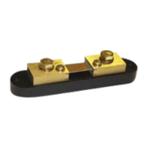

Nichrome is nice for load resistors, but poor for current measurement "shunts." Too much resistance change with temperature.

Nichrome is nice for load resistors, but poor for current measurement "shunts." Too much resistance change with temperature. Rich
Thanks Rich. In this case it is temporary until my order of resistors gets here. Good fact to remember.
From what I have read that isn't true. Nichrome has a much lower temperature coefficient than any common metal. There are special alloys that are better, of course. But for general work, Nichrome is fine. It was one of the first low coefficient materials used to make wire-wound precision resistors. If you check the name plate of a heating appliance and calculate the resistance when the wire is red hot and then measure the cold resistance, there isn't much difference.

Nichrome can make a good resistor if you run it at very low current so it doesn't heat. It's chief virtue is that it has a much higher resistance than copper or brass.
High current shunts are usually some kind of copper alloy. Five Amp shunt:
https://www.rammeter.com/ram-meter-inc- ... rent-shunt
They are massive because the goal is to minimize heating for the sake of accuracy.

The copper alloy leaf(s) which is soldered into these DCA shunts end brass blocks is usually referred to as a "manganin". If one is sending through one of these shunts anywhere near their capacity, then it's a good idea to take the ready sooner than later, to avoid possible heating effects reading errors. Many lower Amps reading DCA meters already have installed inside their cases the shunt; but larger Amps meters (usually above around 25A) normally will require connecting to them a shunt, like the one pictured above, because the larger Amps shunts are too large and heavy to be installed inside the meter's case. On both Simpson and Triplett analog VOM's, their 10 or 12 DC Amps range is supplied by a makeshift (mechanically attached at the factory any-which-way that works) DCA shunt which is simply a fairly long (up to 10 inches long in some models) thick-diameter solid wire made of manganin; one can easily spot it inside the VOM case; nothing else looks anything like it. If anyone buys a higher Amps meter online; it's good to know that the needed shunt may or may not be installed inside the meter's case; & many online sellers simply don't know that the shunt might be missing, because they don't understand DC Ammeters or haven't bench tested the unit.

Manganin is another low temperature coefficient alloy that, like Nichrome, was used in early precision resistors. They are probably still in use.

Manganin works great because it's stable and you can solder it, but it can be hard to buy or expensive. It is not a good material for high temperatures. Something else that works well is Constantan (aka thermocouple) wire. It has a high voltage coefficient against copper but that's not usually a problem because you'll have copper leads on both sides. With a decent flux you can solder it, though not as well as manganin. To get a precise value easily, measure out a long piece. say one to ten feet and measure that. From that you can get ohms per inch and if you measure short length, it should be near dead on.
