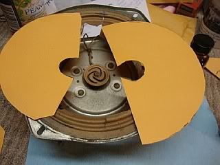

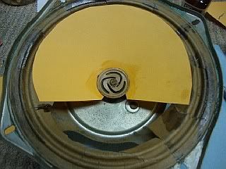

This is from Mark and his comments. Nice approach to recone, he like many has not quite mastered the posting of pictures. This came by e-mail from him. Jerry
Ok attached are some pix of Philco speaker I made a cone for recently. Note I made some mock ups first, then test fit it since I am NOT an artist. A little refinement and it fit under the voice coil and up to the surround... I did it a little at a time. When done, it played like new.
Materials... X-Acto knife, glue (rubber cement mainly), electrical tape (to temporarily hold stuff in place), manilla business envelope paper and scissors. Oh, and about 70 minutes of time.

you often can not use another cone... due to the pitch (depth) of each speaker being different... its very hard to do. My method will always work on any vintage radio speaker that has an intact spider and voice coil and some area of scrap flange at the voice coil to bond to. Also, really helps if there is some surround left as there was in this case, I was able to re-use it. Otherwise you have to make one with chamois or similar material.

If you look at the finished cone carefully, you will note I cut the abutting edges of the two "halfs" (they are each more than half) so they interlocked. Made it easier to join and glue up.
The main criteria for any such repair is that the voice coil and spider are in good shape and secured (in this case it was an excellent internal spider with center screw) and that you either have a salvageable surround or can make such. Note the original speaker cone was in tatters but enough of the surround was still there to save lots of time from making a new one (if I had to, I use a chamois like cloth or used dryer sheets coated with a flexible cement).
Also, I could have sprayed my envelope material with flat black spray paint to darken it. Also there are some recycled paper business envelopes I used to see that were a grey-greenish color but I dont see them around anymore.
This type of repair is do-able for most anyone using simple cheap materials in the home.
Dont worry about appearances... the worst looking cones can sound just fine. NEVER, EVER discard an original salvageable electro-dynamic ("ED") speaker! They are used in part of the radio's power supply and usually have the output transformer (OPT) mounted on them as well. In a console, you can sometimes mount a damaged ED speaker off to the side and put a newer PM speaker on the soundboard. Just tie the voice coil (VC) wires over to the old one and unhook one of the old VC wires from the OPT.
