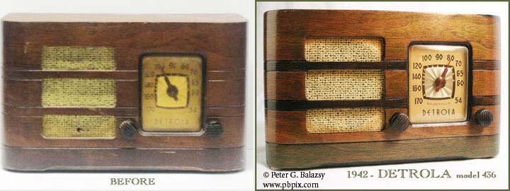

When I have a badly cracked or missing lens I can make my own out of polycarbonate plastic over a form in the oven.
Nice.
But when the lens is just old and cloudy yellow I can clean them up quite nicely.
I've recently found that an old yellow cloudy scratched dial lens can be restored to almost new.
I soak it in 50/50 bleach-water from several hours to overnight. This removes (not all) but most of the yellow and makes the plastic more supple and flexible. After rinsing and allowing to dry I finish the job with Brasso. Brasso is a blessing here!
The lenses I've done this way came out looking great. Not crystal clear exactly but with just a very slight residual amber tint.
Looks so nice and authentic.

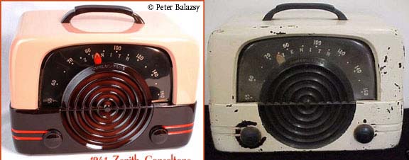

Here's a couple before and afters
you mean you wouldn't try it unless I can prove it?... lol

Nice Peter............really nice. I do believe I'll give it a go !
And..........ditto on the BlessingsofBrasso............been a user of that stuff on radio cases for many years.
