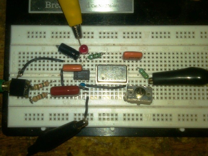

PostPosted: Dec Tue 04, 2012 5:47 pm
Posts: 2040
bill hamre wrote:
Heard from hergi he is breadboarding as we speak.
OK so I am slow. I got mine working on a breadboard and I have to say it sounds good and covers well for just a few parts. I just use the transmitter section running off 7 AA cells. Now I have to stuff it in a box. :shock: I get about 10.6 mA draw when the antenna is peaked. Pin 7 has about 4.5V.
Doug
 Post subject: Re: LM386N MK-XI BCB Transmitter
PostPosted: Dec Tue 04, 2012 6:06 pm
Posts: 12180
Way to go Doug, guess we can call off the search party... :wink: I used my breadboard version most of the summer till I finally built the one in the satellite meter case...
Your current readings are fine, should be a good performer for you...
PostPosted: Dec Tue 04, 2012 6:30 pm
Posts: 2040
I had oscillation problems at first but changing the layout and shortening leads cured it.
Thanks for the fun project! Thanks for the kit Bill!
Doug
PostPosted: Dec Tue 04, 2012 8:37 pm
Posts: 6311
Pictures please.
PostPosted: Dec Thu 06, 2012 12:40 am
Posts: 2040
Sinced you asked so nicely Mike.
It's just a breadboard though.
Doug
