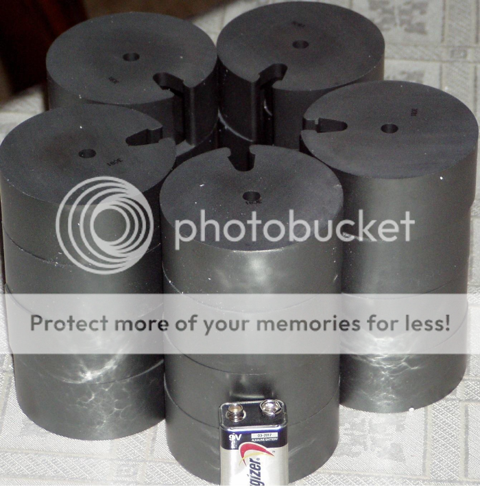

Hi Guys,
I have these potcores, is it worth me lashing them up for a try?
About 4.25" H x 7' OD
I have 2 more cores should I go 4 sets high with 3 in the circle.
About 8.5" H x 6" OD.
Mikek

Hi Mikek, you'll never know until you try. Do you know what type material those are made of?
If you do experiment with these, it would be interesting to see the results.
What would you wind the coils with, litz? Anyway, good luck with your project!
I'm glad to see some finally responded!
I just made myself a form to put the cores in and decided to check in to see if anything was said.
For a first attempt I made 3 rods from the 12 cores. I wrapped a sheet of paper over it to keep
the wire from falling between cores. I had a piece of wire (13ft), I wrapped it and got 8 turns.
I tested it and found it resonant at 1388kHz with 475pf. My mind is mechanical today, don't
want to do any math, but I think ? doubling turns quadrupals inductance, so if I double it twice
I will have about 230 microHenries.
I did put a radio near it and it did enhance the signal at 1260 kHz even though I could only tune
down to 1388kHz.
It's a start.
Mikek

I ended up with 21 turns wide spaced.
One of my locals 590kHz is producing 90 mvpp setting on my bench,
with all the equipment and metal around.
I don't know what to expect.
I need to do some more measurements on another day.
The material is 3C81,supposed to be good to 2 or 3 MHz,
but I think I saw a large drop in Q at higher frequency.
Q= 114 at 530kHz and Q = 16 at 1407kHz, but thta's so bad
I need to recheck it.
I used a solid #16 wire, don't want to waste my Litz until I have a
feel for what's going on.
Thanks, Mikek

I rechecked this evening, and my Q= 113 at about 530kHz
and a very dissappointing Q=17 at 1350kHz. About the same
as I measured earlier today.
I think the material losses increase at the higher frequency.
When I tuned it to my local 590kHz I get 0.175 Vpp when
the signal is at peak modulation.
Any thoughts?
Mikek

You might try spacing the wire away from the cores, such as with some foam sheeting or similar method.
 Post subject: Re: Ferrite Sleeve Loop antennas: Are they for real?
PostPosted: Feb Fri 20, 2015 11:55 pm
Joined: Feb Sat 22, 2014 1:40 am
Posts: 292
Ya, I wanted to do that, but a search of garage and shop didn't pullup
any foam to use.
Do you have any theory that doing so would increase the high frequency Q?
I looked up the datasheet, the material losses are high at frequencies much lower
than I expected. We used it at 660kHz regularly and a 1 MHz on occasion, at power
in the 100s of watts, in a smaller core.
The spec's look bad for this use.
http://allstarmagnetics.com/assets/3c81.pdf
I have a lot of ferrite pot cores, but nothing like the size of these cores.
Mikek

I took my FPCTRA ( Ferrite PotCore TriRod Antenna), hope that doesn't stick :-)
out into the yard just now. I only worked at the low end 530kHz to 550kHz.
I certainly made a huge difference in signal. I went from a signal that at full volume
I could tell something was there to, I had to turn it to under half volume and it was very clearly
understood. One station was just not there until I got the radio close to the FPCTRA then I
had a station clearly understandable, well except it was Spanish. Either Cuba or Miami.
I'm in Panama City Florida. I set it up so I could rotate it and found two stations on the
same frequency, I could null either one to hear the other. BTW, you can get the radio to close,
you need to space it 2" to 3" away.
The ferrite material may make a decent LW antenna, but I need some more info about
the Q's FSL makers are getting. If they are getting Q's of 500 or 600 and I get 114, it's probably
better to sell the cores and invest in a better material for the AM band. These 12 cores list at $278.
I got them after a business closed.
Mikek
