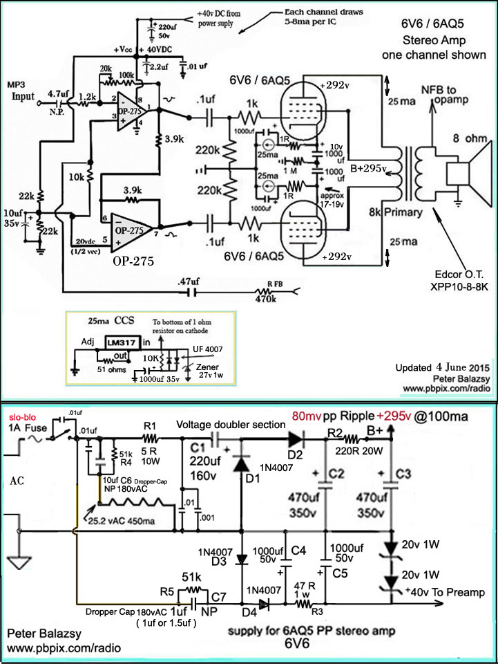

Here's the latest state of the amp:
When I used 200 ohm cathode res. the current per tube went up to 30ma and the bias was 12.5v
With that set up and SG connected to B+ , I was able to get approx 6.5 watts out into a speaker and about 5.5watts into an 8 ohm resistor.
I found that when I cut the current back to only 25ma/per tube everything still "sounded" terrific and it will make my power supply a little easier to build... but I will need to do some thinking about that yet.
I intend to make a voltage doubler and I hope it won't be too high in the first stages before I cut it back to +235 for B+. I don't want to have to use big wattage dropping resistors between filter cap stages to bring it into the 235v range.
Anyway.. I have now added individual 25ma CCS for each tube with 1000uf by-pass caps.
That requires the cathodes to be separated... and so ..then I re-coupled the cathodes together capacitively.
The greatest advantage of using separate CCS for cathode-bias, is that each tube will always auto-magically be biased to operate exactly at 25ma. Regardless of the tube age or brand!
... I will not need to have matched pairs and anytime the tubes are ever changed, the bias never has to be readjusted.
It's the perfect "auto-bias" .
Each cathode voltage is now at approx +13.5v which the CCS will automatically vary as needed in order to achieve the exact 25ma bias current.
With CCS as cathode-bias, the current in the OT will also always be perfectly balanced as well optimizing its performance.
What more could one ask for?

Here's a regulated version of the supply:

Peter
I am getting some 1%s for the 50 ohm resistors in the CCS.
Do you suggest any others be 1 %?
Also, I have a 13K ohm for the preamp power circuit.
Will 1 watt zeners be OK? We should need .6 watts, I think.
John Smith, over and out.

Peter
You don't need 1% but they are very nice to have. Helps eliminate tolerance build-up oversights in my design.
I thought you showed me three 39k 2w resistors you were combining for 13k.
1 watt is fine for the 40v Zener string. Esp if you use two 20v 1-w Zeners in series = 2 watts total
Remember the entire 40v load is not more than 15ma. The 2 op-275s use 10ma... so that leave 5ma through the Zeners.
40 x .005 = 200 miliwatt
the other 400miliwats is used by the op-275s.
So the only time you'd see 600mw would be if the op-275s were disconnected and the Zener had to handle the entire 15ma.

john8750 wrote:
Peter
I am using 3-39Ks to get a 13K.
That's what I figured about the wattage of the zeners.
I don't understand how the two 1 watt zeners in series will handle 2 watts.

john8750 wrote:
john8750 wrote:
Peter
Zeneres in series are similar to resistors in series.
Each zener has its own separate voltage drop so the wattage is divided across them
If a 40V Zener passes 5ma ...
40 x .005a = .2 watts
But two 20v Zeners in series share that load.
each Zener:
20V x .005 = .1 watts

Tonight I was double checking values and measuring voltages etc in the power supply.
I felt that C1 was a little warm ( 47uf @250v)
so I tried increasing the voltage rating and put in a 47uf @450v .... but that one too seemed to get a little warm.
This puzzled me.
I tried a few different styles and brands of 47uf @450v .... and I did find a couple that do not get warm at all.
1.) axial type 40uf @450v .... ran cool
2.) radial but physically larger than the "warm" one... and that runs cool too.
So maybe the warm ones I had are just bad or a little leaky or poor quality.
So I suggest you keep a good eye on that C1 cap. ( it actually should be fine @ 250v)
But just to be safe... feel it to see if it stays COOL after a while of use ...and just be sure to use a good-quality 47uf@450v just to be safe.
 Post subject: Re: 6V6 / 6AQ5 PP Stereo Amp
PostPosted: Apr Sun 12, 2015 11:14 am
Posts: 9666
Location: Texas. USA
I felt that C1 was a little warm ( 47uf @250v)...
It's the cap ESR. You may need either one with a lower ESR or a larger cap.
