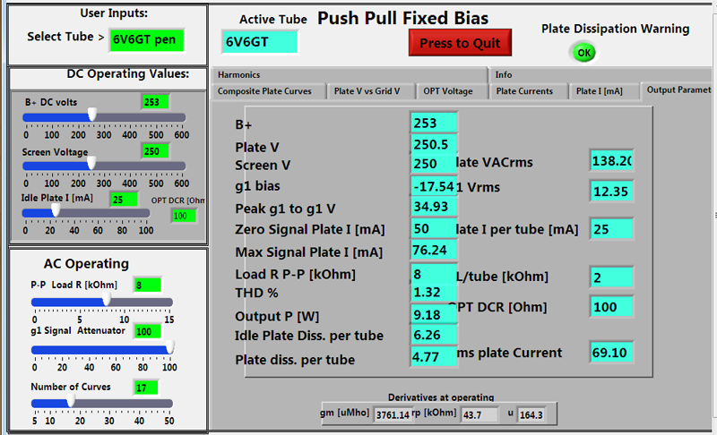

Chuck's Plate Curve program shows that with:
B+ 268
250 from plate to cathode.
-17.5v G1
25ma /tube at Zero signal.
So that's 50ma per channel for a total of 100ma + SGs ( 1ma each now) .... and another 13-15ma for the preamp and Zeners.

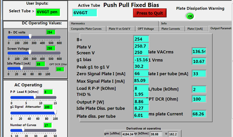

When I use Chucks program and enter -15v for bias with pushes idle current up to 33ma.
The power output actually seems lower compared with -17v and 25ma idle current.
The datasheet load for 10 Watt is 10K PP, not 8K.

I tried 10k to see if power improved but it did not show it on that program. Optimum kept showing 8k.
If I kick up B+ or plate up to 300 v then I think (not sure) the 10k load shows more power.

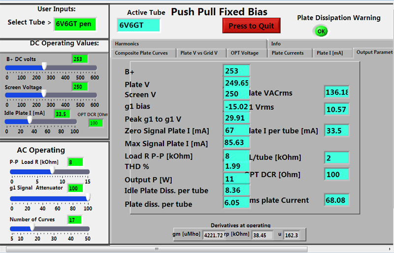

I don't know exactly what changed but NOW entering -15v bias and 33ma current ... I get 11 watts @ 8k load.
10k load shows abot 8.8watts.

Flipperhome wrote:
All I can say is the datasheet says 10K for 10 Watt and every commercial amp maker used 10K (when B+ was 250 V).
Did you look at the 2nd screen-shot I posted for 15v bias?
I said " Something MUST have changed because it NOW shows 11 watts"
entering 10k made the power drop.... so it peaked at 8k.
Maybe chuck knows why.
Scroll back up 4 posts.

Yes, I saw it and my post stands. The datasheet says 10K for 10 Watt and every commercial amp maker used 10K (when B+ was 250 V).
