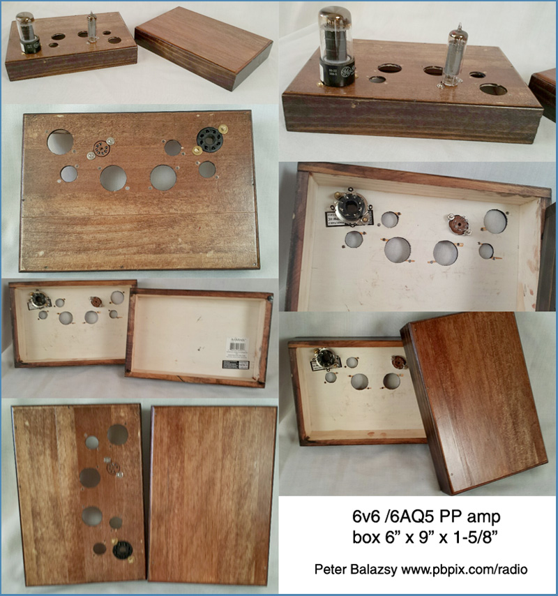

 Post subject: Re: 6V6 / 6AQ5 PP Stereo Amp
PostPosted: Apr Sat 18, 2015 10:51 am
Posts: 23703
Status:
Yesterday I shellacked, and varnished the box w/wipe on polly. Looks oh-so nice.
The basswood top is very very thin... 1/8" maybe.
Tonight ...I carefully used a 5/8" and a 1" spade-drill to cut the 4 holes for the four 7-pin sockets and the four octals.
I'll have 6v6 tube sockets wired in parallel with 7-pin 6AQ5 sockets so as to have an either/or alternate tube choice.
I used a Black&Decker little battery powered hand drill and it turned at the perfect speed. I taped over the top to protect it and also started drilling up from the underside 1/2 way and then from the top down. Wow... perfect hole. Nice.
But since I'm mounting the octal sockets underneath, .... the hardware on top stopped the octal tube base from going into the socket all the way. So I had to file 1/2 the heads off to make it fit... arrrgh.
But it worked.
I did one octal and one 7-pin socket... the rest tomorrow.
Headway.

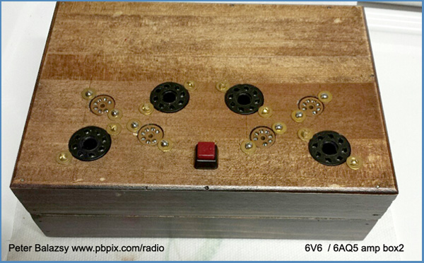

PostPosted: Apr Sun 19, 2015 12:22 am
Posts: 23703
Here's last night's progress. Tonight I'll attack it a little more :lol:

Excited to see your progress Peter. Why did you stagger the tube sockets? That's neat.
The real test of good wood is the smell before the finish goes on.
Is that 202uf capacitor critical? Or was it very late at night.
I will start my chassy soon. Today, I bought some red oak for the ends of mine. They will be glued on with liquid nails.
Please share your ideas for the preamp and CCs boards. And OT mounting....
John Smith, over and out.
202uf is very rare.
but yes it was morning when I hit the sack.. sun was up.
I staggered them initially because the 6v6G coke-bottle tubes would have been too crowded. But then when I decided to add the 7-pin sockets it all made more sense. And it looks cool... :mrgreen:
My OTs will be placed behind the tubes evenly spaced but nearer to center.

Ok here's what I got done tonight:
I only had steel-colored 4-40 screws for the 7-pin sockets and large brass washers. I think 2morrow I may try to get some less conspicuous-looking, more appropriate-sized brass 4-40 screws and smaller washers for them.
