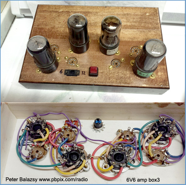

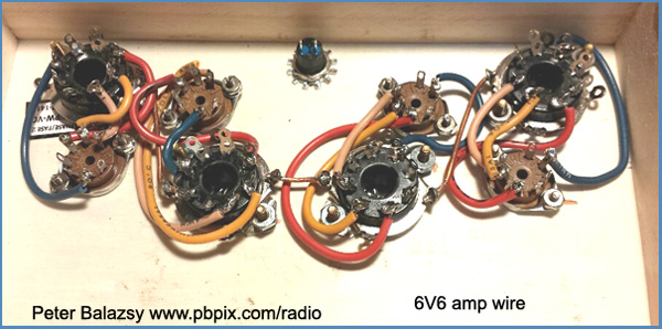

Here's tonight's progress of wiring the correct respective active pins for the octal and 7-pin sockets in parallel. All except the filaments:
Nice Peter. Some great work there, and inspiration.

I see you bonded all the sockets. Will that serve as a grounded chassis?
Made me think. I never did ground the output transformers on my amp.
I guess they didn't need to be. The sound is already so sweet.

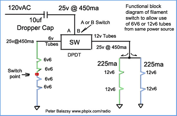

I wired all the filaments. Also mounted dpdt A/B switch in the center of the filament string.
The idea is to be able to use the same 25v@450ma filament power source to feed either the 6v6 tubes or the 12v6 tubes depending on which ones I have in the same sockets.
Had to put my brain into gear to figure out the switch wiring...lol
See if any of you reading this can draw it.... maybe easy for you but I had to really think twice. :lol:

Hi John:
Yes I bonded all the sockets but simply to allow that to be my common ground tie point. (B-)
One side of the OT 2ndary should go to (B-) yes.

IC peter.
Could you have just wired up all sockets, then remove the set your not using?
John Smith, over and out.

john8750 wrote:
IC peter.
I did that. But not the way you're thinking.
I will either have all 4 sockets 6V6 ... then the switch goes into the 6V position... and all sockets are in series.
BUT... When I pull the 6v6s out.... and use the 12V6 tubes in those same sockets, ..then I'll have to slide the switch to the 12v position so as to re-arrange the socket wiring so that the string can be split in two paths.
There's only 4 sockets and if they have 6v6 (450ma ea) ... then they ALL (4) are in series 25v @ 450ma.
But if using 12v6 (225ma ea) then I have to split the string into two parallel sets of two tubes so that the 450ma current SPLITS and feeds each string of 2 so that each gets 25v @225ma.

Yeah.. the "smart ckt" is my finger on the slide switch!
I was originally going to do it the easier way: I was going to keep the 12V6 tubes all in series too and use a second dropper cap (5uf) for that current. But four 12v6s in series would required 50v @ 225ma. Then I could just use and A/B switch to switch between the 10uf and 5uf dropper caps.
But I didn't like having the filaments up at 50v ( don't know if it would have mattered but sometimes there are voltage limits from cathode to heater)
It would have required another dropper cap too.
But the way I'm doing it now still requires a slide switch but not an extra dropper cap... and the filament string supply voltage stays at 25v@450ma
So it's just a more elegant solution.

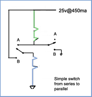

John:
Here's the actual wiring arrangement for that A/B switch should you decide you want to add the 12V6 tube option to your 6V6 amp as well.

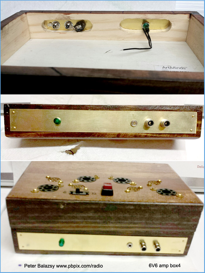

PostPosted: Apr Wed 22, 2015 8:41 am
Posts: 23663
Tonight was just a lot of slow careful hole drilling and metal cutting.
I had to rout out the thick wood on the lower front and then cover that w/a brass plate so that I can mount jacks and lamp etc.
I got most of that done without incident but it was slow and anxious type work.
Anyway... I don't have the front hasp mounted yet and I think I'll wait till I get the back hinges in place first.
So here's what it looks like at this point:
