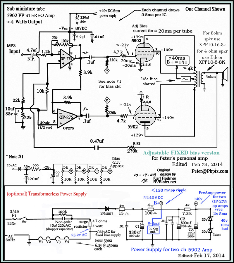

Hey John... here's a regulated version ofthe supply. I put the LR8N3-G HV regulator to work.
But I had to set the B+ back 5v to +230v ... to keep the output at least 15v below the input for optimal ripple reduction as well as regulation: Works nicely with a heatsink on the TIP50. It's only regulating about 20v @ 115ma ... so that means it has to dissipate about 2-1/2 watts.
As a side note:
This regulator is nice.. but I'm not sure it's really worth the bother .... after all we're only replacing one 120 ohm resistor and a 470uf cap .... and even though the ripple is next to nothing... it wasn't bad before at 100mv. So the choice is up to you.

What about the CCS's? I will do it the way you suggest.
You are doing a lot of fun work there.
Thank you.
John Smith, over and out.

What about the CCS? You make it same as the 5902 amp except use a 51 ohm resistor.
For 25ma current:
1.25/.025a = 50 ohms
 Post subject: Re: 6V6 / 6AQ5 PP Stereo Amp

As for 'complex', fixed bias is superior to any cathode bias and worth it for the improved bass from line transformers.
I was using the term "complex" about the pwr not the amp.

Well... there two areas of concern:
1.) ....overall system "power supply" regulation
and
2.) Audio output amp area ... "signal" current regulation through the tubes and OT.
The LR8N3 is a (3-terminal) HV voltage regulator meant to adjust the overall system power supply voltage.
The CCSs on the other hand are used in the output signal loop area to keep current fixed for improved "self-bias" regulation.

Flipperhome wrote:
I know. You need the 'power' negative rail for the fixed bias.
Sure.
Depends, I guess, on how one chooses to do it.
When I tested "fixed bias" for my 5902 amp I did it a little differently:
... since fixed bias requires almost no current, I just borrowed some of the 25.2 volt AC filament voltage. At that point I taped in with a 1N4007 (reversed) and a little pi-filter with a cpl caps.
I fed that to a variable resistor arrangement. So no extra "negative rail" needed.
Voila! Worked like a champ.

I hate to break it to you but -21 V is a negative rail.

Flipperhome wrote:
Sure.
Duh.. yes I know ...of course.. but I just meant I could tap a little off the filaments without having to build a typical full, mirror-image "classic" type +/- dual power supply.
But it's semantics.
