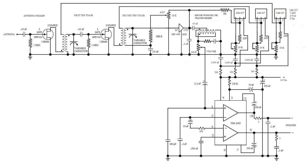

I recently found another interesting receiver using the MK484.
Let me know what your thoughts are about this particular design.
 Post subject: Re: Simple Solid State TRF with Selectivity
PostPosted: Oct Mon 30, 2017 7:53 pm
Posts: 36219
The print has symbols showing that it's most likely a design out of Europe or Britain.
Seems somewhat complex, and I'm wondering why the nine volt supply, for a chip designed to run on about .9 to 1.1 volts (plenty of Transistors can operate on 1.5 volts).
Interesting that they use an IF coil as the input tickler to the chip. Let's see, 6 coil windings, same number of Diodes, and I can't count high enough for the resistor and capacitor numbers, lol.
Is there any review on how well it's supposed to operate?

The "Design1.jpg [ 79.32 KiB" circuit is a superhet. So it was pretty natural to use an IF transformer as the IF transformer. If you inserted a proper IF filter there, this circuit should work about as well as the common 5 or 6 transistor radios did.
The MK484 is used for the IF & detector stages. It's run on about 2VDC.

If Q1 is a PNP as shown it cannot work.

Peter is correct, it will not work..
Maybe its a misprint.
PostPosted: Oct Mon 30, 2017 11:37 pm
Joined: Jan Tue 16, 2007 7:02 am
Posts: 3920
Location: Lexington, KY USA
You are right. PNP won't work. Symbol and specified BC558 are PNP.
There is at least one more schematic error: Varicap D1 has no DC bias for its anode. The whole varicap tuning scheme seems suspect. I don't see how they would get it to track, and the oscillator tuning needs the series pair of diodes more than the antenna tuning does.
I suspect that this schematic is a mash-up of parts of other schematics. I wonder how many poor fools tried to build it. The basic idea may not be bad, but details do count!
These sorts of errors are very common in circuits found on the internet, as they were in the old "Design Ideas" columns in trade magazines.
I don't think so. Much above 1.5 volts will destroy it. It was designed to perform best at right around one volt, but can tolerate up to about 1.6 volts.
PostPosted: Oct Tue 31, 2017 8:53 pm
Joined: Aug Thu 06, 2015 2:20 am
Posts: 283
Don't the 3 diodes perform as a voltage regulator of about 2.1 V and doesn't the 1K R10 further drop the voltage to the required value?
