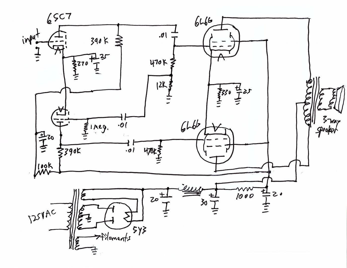

I have this thing playing, but am awaiting a better (more iron) output transformer and now have a decent 3-way speaker.
It has 347 volts on the plates of the 6L6g tubes.
I had a radio chassis with a power transformer and choke, so decided to make an amplifier to combine with my Browning laboratories tuner to make a radio.

Just curious, should the 390k plate resistor for the top 6sc7 actually be 290k? Or is there a mistake in the drawing?

I have 390K units in both positions. That gives 154VDC on Pin 2, the plate of the top triode section of the 6SC7 on the schematic. and 179VDC on Pin 5, the plate of the bottom triode section of the 6SC7 on the schematic (all voltages measured from plate to cathode).

When you get your better output transformer suggest you feed screens
from a voltage divider. Here are the values from the old RCA manual for the
6SC7 as a phase inverter.
If your transformer can support a 5U4G, the 6L6s might work harder for you.
I don't have much experience designing tube circuits just lots of repair and informal poking around. So help me understand, what is the benefit of running each plate at different voltages? It looks like all the other parameters are the same for both.

I suspect it would work better with the voltages the same, but I started with values from the radio design. I probably should get a paper copy of the RCA receiving tube manual, as it is obviously very helpful. The thing already has more gain that I really need, although that might come in handy for bass.
The problem isn't the two 390k, it's that you've got a power supply filter in between the two triode plates causing B+ to be higher (or lower, depending on which is reference) on one than the other.
You're probably taking a cue from other schematics showing additional filtering for the 'sensitive' input stage but the fact is they're both just as sensitive to PS hum in the circuit you're using. The filter should be moved to the front of both, not just the one.

Btw, you don't need a bypass on the 270 ohm triodes common cathode bias resistor and, in fact, it might perform a little better without it. The two triodes, when 'perfectly' balanced, have a combined cathode current that is essentially DC. I.e. one goes up while the other goes down and vice versa. The cap should be doing 'nothing' because the cathode sees only DC.
In actuality, nothing is 'perfect' and paraphase inverters are notorious compromises that lends to large (by comparison) imbalances. This is where an unbypassed resistor could be of benefit because it will 'fight' the imbalance. I.e. which ever tube is conducting 'too much' will impose a cathode voltage that will retard the exuberant tube while simultaneously encouraging the laggard tube to conduct less (which is 'more' of the opposite phase). In other words, it helps to keep them in balance. Now, it can't fully correct (feedback never can) but it's better than not doing anything.

The 390K plate load resistors are too high in value and the 270 ohm cathode resistor is too low. This causes the 6SC7 plates to run around 65V, and this causes the stage to "run out of gas" and start clipping before the output stage can be driven fully. The plate loads are now 150K and the cathode resistor is now 470 ohm. I changed the 12K resistor in the voltage divider for the inverter to 10K for better balance. It will probably have to be a potentiometer so best balance between the halves of the 6SC7 can be obtained and get equal amplitude signals to the 6L6 tubes. The 6L6 cathode resistor is 250 ohm in line with the recommendation in the RCA tube manual. The 1K screen dropping resistor is now 12K to get closer to the recommended 270V on the 6L6 screens. I powered the inverter stage off the full 350V, but it could be decoupled through a resistor and capacitor if desired. I assumed a 6600 ohm plate-to-plate impedance for simulation purposes. In simulation the power output tops out around 15W. The input grid of the 6SC7 needs a resistor to ground. The coupling capacitor to the inverter section of the 6SC7 is unnecessary because the 6L6 grid and the voltage divider are at nearly zero volts since you're using cathode bias on the 6L6s.

Of course you do. The bottom triode plate is fed B+ through the 390K resistor, but the top triode is fed B+ though its 390K resistor plus the 100K resistor and 20uF filter. The bias current of both halves of the 6SC7 being pretty close to the same by the common cathode resistor as Flipperhome pointed out, the zero-signal plate currents would be close to the same. The extra 100K in the top triode supply would drop the additional voltage. What's the plate current? (179-154)/100K = 0.25mA
Hold your horses there Tonto. :wink: I didn't say anything about the (static) bias currents being equal with unequal plate voltages. In fact they won't be equal and the common cathode resistor (vs separate Rk) will only exaggerate the difference. That will, in all likelihood, also affect the gain and, hence, balance (signal). Then there's inherent gain differences between the two triodes and, of course, the resistor divider driving the second tube is also critical for balance. It's not a trivial task getting 'good', let alone 'perfect', balance with a paraphase inverter.
Btw, my suggestion was to move the PS filter to before both triodes so plate voltage would be equal.
