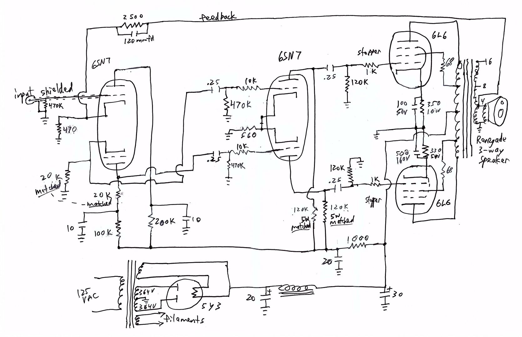

PostPosted: Mar Mon 04, 2019 12:39 am
Posts: 10315
It is playing nicely and it is fun to listen to my 1951 Browning RJ-12B tuner with it. I'd have to buy a different power transformer to get significantly more out of these tubes. With the voltages shown, they are being driven gently, so should last a long time.
With the Browning tuner and Renegade speaker I intended to use:
The schematic
 Post subject: Re: How about this 6L6 amplifier
PostPosted: Mar Mon 04, 2019 2:02 am
Posts: 20494
For the cathodes of the 6L6 tubes try shorting them together and see if it does any better.
