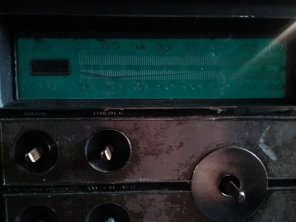

I pulled the panel and the glow looks a lot like the color of the instrument panel I posted.
The plastic panel that is over the electroluminescent panel has a slight blue tint to it which possibly affects the color slightly.
I did try the panel on120Vac 60Hz where it drew just under 1mA.
At 200Hz it drew 2.2mA.
At 400Hz it drew around 1mA.
So it may be that they found the same material optimised for the 200Hz inverter used in cars worked well enough for home use.

At 200Hz it was a little brighter.
Now at 200 volts which is what the electroluminescent panels used in some cars ran at, the panel was noticeably brighter.
Personally I feel they built them the same as they did for the cars and found the lower frequency and voltage produced a usable enough brightness.
Can't say I noticed much if any real color shift.
Didn't want to do too much testing on it as if I send the panel out to get it restored I figure they would want to see the panel light up.
Now if it is better to do so I can perhaps make a tiny 200Hz 200 volt inverter somehow then use a resistor to set the brightness provided said inverter won't interfere with the radio.
I could also just find the circuit used in the cars, duplicate it and install it in the box I used for the radio's power transformer as I have plenty of room there for an inverter. I have the area in the rear panel where the original power cord connector went so I could mount a jack there for the panel's power.
If 60 Hz will work (know it does, but don't know if 60Hz or 200Hz is best for the longevity of the panel) I can use a Triad N-68X isolation transformer either wired normal for 120Vac operation or wired reverse for 230 volts if 120Vac is not bright enough and just use a variable resistor to set the brightness.
