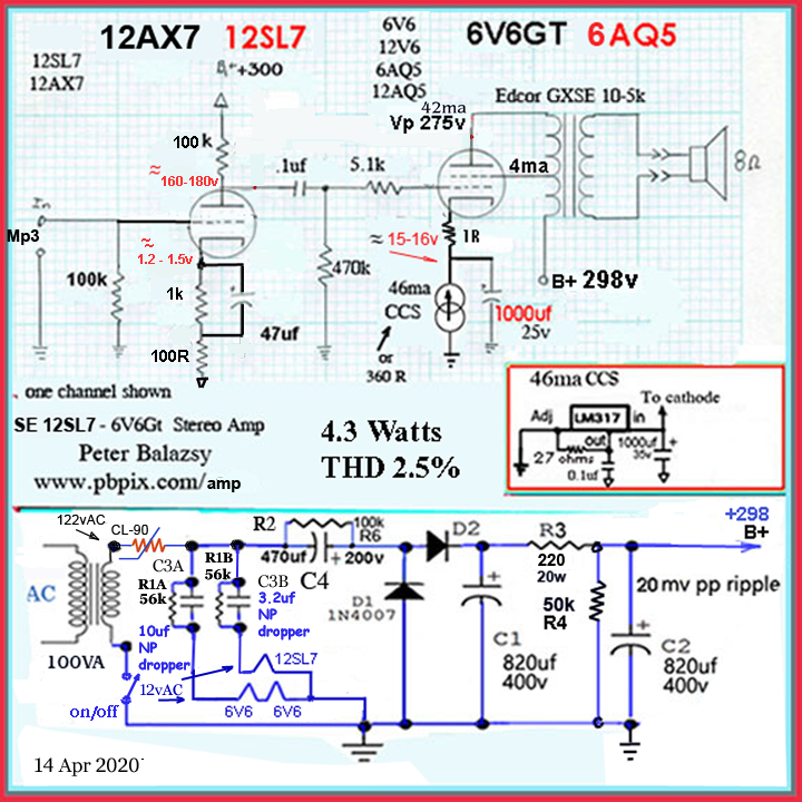

A revisit to a great simple project:
Just sitting here tonight enjoying listening to the fruits of my labors from last year.
Here's my single-ended 12SL7 - 6V6G stereo amplifier.
These 6v6g tubes were made about 84 years ago in 1936... still creating magnificent sound!
Note: The extra sockets on the chassis are for optional use of (12sl7 or 12ax7) and (6v6 or 12v6 or 6aq5 or 12aq5) Whatever of those tubes you can find can be used in this amp as per design.
All prints and other images are on my web site http://www.pbpix.com/amp .

Here's the inside wiring of the chassis tubes underside and the power supply.
So you can see how simple and easy it is to build. Remember I have three extra parallel sockets to allow for the alternate use of miniature tubes as opposed to octals. So you can see how much less wiring there would be without including the extra sockets.
The last image, of course is the top view.

Today I tried rolling tubes.
I used a 12AX7 as the driver and 6AQ5s on the output and got REALLY surprisingly nice results.
Things sounded " Brighter/crisper"'
I pulled the 12AX7 and used its low noise equivalent tube the 7025 and that is wonderful as well.
I realized that the 12AX7 or 7025 has greater gain compared to the 12SL7 I had in there so I think that everything sounded better partly due to the higher drive signal.
So I pulled out the 6AQ5s and put the 6V6G tubes back... and this combo does sound fine too.
So if anyone here decides to build this great little amp, I think you'll be impressed using a 12AX7 or 7025 driving the 6AQ5 or the 6V6g....
But if you prefer to keep it small, then the 12AX7 or 7025 driving 6AQ5s is a great choice; and probably better on the budget.

I built the amp before and love it.
I've used it with both the (octal) 12SL7 as well as with the 9-pin 12AX7.
I'm sure you'll find, as I have, that since 12AX7 has more gain... you'll like the performance better.
( btw: the 7025 tube is excellent too because it is exactly a 12ax7 but built to be quieter)
https://frank.pocnet.net/sheets/168/7/7025.pdf

PostPosted: Mar Sat 07, 2020 9:47 pm
Posts: 22762
BTW guys... for the 50k bleeder resistor (R4) in the power supply, I used three 150k 2watt resistors in parallel.
298v / 50,000 = 6ma
6ma x 298v = 1.8 watts ( triple for safety) = approx 5 or 6 watt resistor
Using these big 820uf caps
https://www.ebay.com/sch/i.html?_from=R ... =0&_sop=15
will cause a heavy initial surge on power-up; typically enough to keep blowing your 1amp fuse. So by adding a CL-90 inrush limiter you'll avoid that problem. ( you could have less in-rush current if you drop the filter caps down to 470uf but the ripple will be higher.)
https://www.digikey.com/product-detail/ ... ers%20(ICL)

lwhite46 wrote:
Peter,
I have several 12AT7 tubes on hand. They have less gain, similar to the 12SL7. What are your thoughts on using a 12AT7?
Hard to say for me because I haven't used it.
But it has lower gain than the 12sL7.
I think this list for gain is accurate?
12AT7= 60
12SL7 = 70
12AX7 = 100
I think as far as feeding the input with Mp3 levels ( I use a Sansa Clip+) that the best results are from using the 12AX7.
Someone w/more 12AT7 experience can perhaps shed more light on your question.

Hi Peter
It may not be the 12AT7 that is as much as it is that you have to crank up the mp3 player to drive it to get the same level. This could mean the mp3 player is operating closer to its useful level end.
