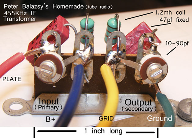

 Post subject: Re: rf chokes
PostPosted: Mar Thu 18, 2021 1:01 am
Posts: 23456
jimbob wrote:
Has anyone used the little rf chokes that resemble carbon resistors. They are much cheaper smaller and more available than say the pi wound which seem hard to find nowadays. Just curious I have some ordered and am anxious to try them !
Yes I used them for inductance value in a home-made IF filter:
viewtopic.php?t=86553
https://www.antiqueradios.com/forums/vi ... 6&t=196404
Wow. I saved the image for future reference.
