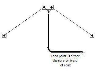

Since my last post in May, I have around 20 brand new diodes and more parts. I set up a 50 ft dipole-type antenna on the side of my barn coming through a window on my workbench. I have also built this untuned circuit download/file.php?id=356047&mode=view see picture below of my exact build.
Since I have a proper antenna I just need proper grounding, unfourtanaly there are no copper pipes that are close to the workbench/antenna without running an excessive amount of wire in the yard.
I do have a very large metal stake that I could try, however...
Henry

whfh99 wrote:
Great website Nandu! A lot of valuable info. I especially liked your QRP page.
Henry
Thank you so much for your compliment, Henry!
Should your dipole have a coax feeder, you would need to use either the core or the braid for the antenna connection. A buried metal water pipe would serve for the earth connection.
Connecting the coax core at the feed point and grounding the braid is a no-no. The weak signal would definitely be lost in the coax.
Have fun!
