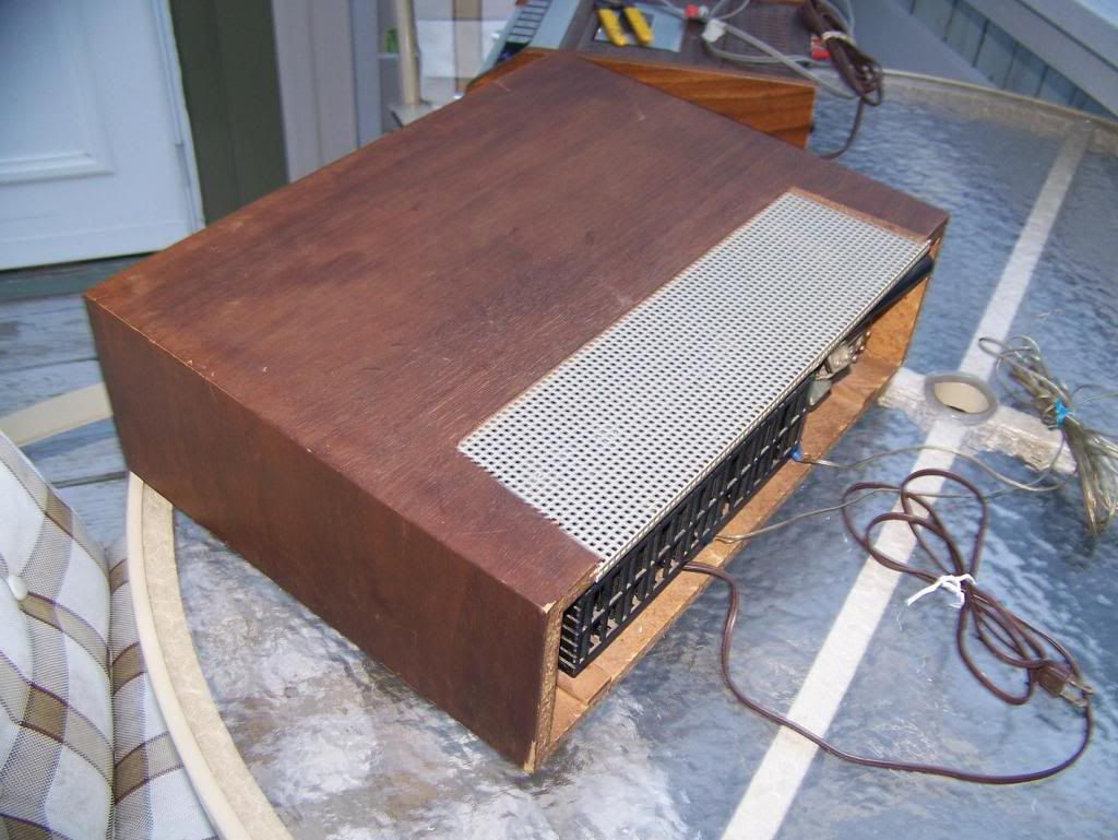

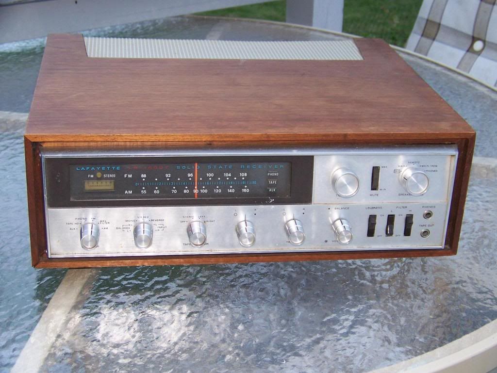

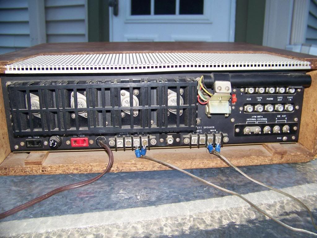

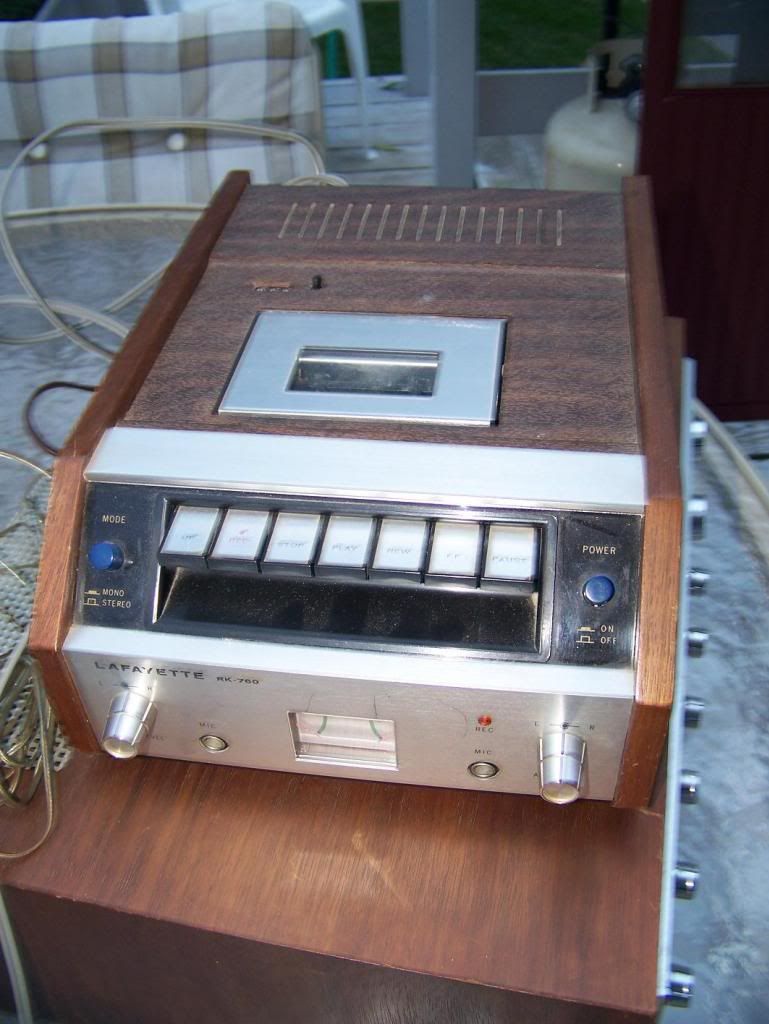

8) Update!
Unfortunately, no pics. :( I still don't know what happened to them. I took some after I went over the case, and they disappeared. Now i'm just being lazy, because I haven't wanted to pull the receiver out of the cabinet I have it in to do a reshoot. Got it all hooked up and its been doing great.
Actually, its doing better than great. :mrgreen: With use, the old thing has gotten quieter. Not as much hiss or odd sounds when the volume is down. Station reception is great (the STA430 didn't do to good in that location). The unit sounds great paired to the speakers I use in that room.
Thanks for the recommendation TubeRadio. I checked it out and that stuff looks good. At the time, I ended up using what my dad recommended that we had around. Some Howards feed and wax. That did a pretty good job and it brought back some luster... To bad it cant be seen in the cabinet. I should have it sitting out, just so I can look at it :lol:
Manualman: Yup, that'd be easy to do now, and to top it off, I can do it without even pulling the chassis out of its wooden case. Its got a mesh metal panel towards the back that can easily be removed, and I can reach them from the opening.
Here's some pictures I found that were still online for view. These are from when I got the 2, a little over 5 years ago.

Wow! RK-760 sold a lot of them. I think I still have tape heads for it. I know I have lots of tape heads for Lafayette machines.
