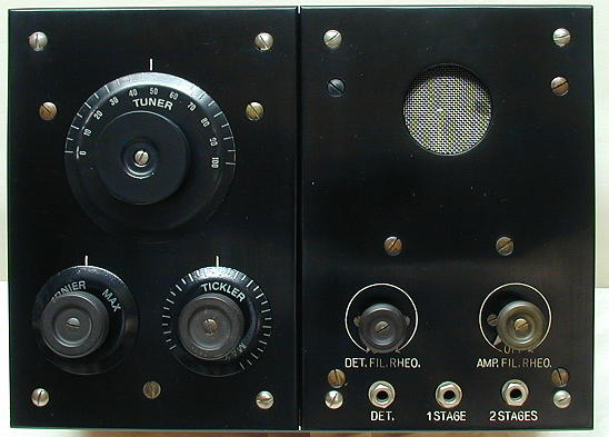

for a starter set I would use the RCA RC set, of course you may want other types such as a TRF, or Superhet to test.
