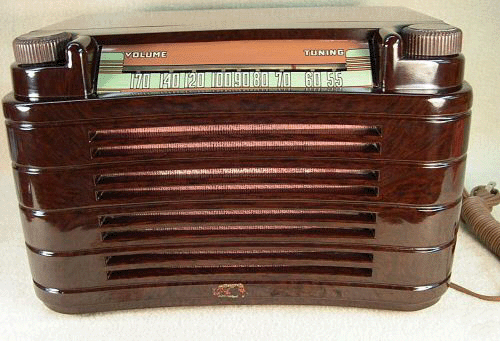

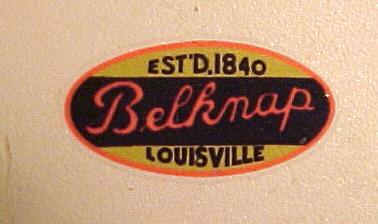

Hi guys,
What am I doing wrong? My cell phone uses Chrome and the images do not appear. My laptop with Vivaldi and FF works fine, but not with Chrome or Edge, or Opera
So i'm having different responses (the images do not appear in Chrome but do appear in FF) here's the posting code:

I cleared the cache and cookies but the images from the code above do not show up.
posted code:
[img]http://www.pbpix.com/BELKNAP-1.GIF[/img]
The only difference is that the posted code has the "[img]"---"[/img]" in the line
But if I enter this string directly in my address window of Chrome the image shows up.

I'm not with you. The images are showing here on my Mac.
A space is assigned number 32, which is 20 in hexadecimal. When you see ā€œ%20,ā€ it represents a space in an encoded URL, for example, http://www.example.com/products%20and%20services.html.

The images don't show inline here but do show with "show image in new tab." in Chrome.
The links are non-secure (HTTP: vs HTTPS:), most browsers will not show insecure content on a secure page. Tried as https:// and the site does not provide a secure protocol.

This is the cause of the problem. Different browsers handle non-secure content differently. antiqueradios uses the secure HTTPS protocol and your site does not.

How can I support it on my site?
And why does it only happen when the AR image code is added ie:"[img]"

How is your site hosted? If it is done by a hosting company then they should be able configure their server software to support HTTPS.
If it is done on your own computer then you have to get a certificate and configure your server to use it.
As for the problem only occurring when using img, img says to display the picture within a page from antiqueradios. and that is where you have insecure content within a secure page.

Ask your hosting site. On mine, it was by adding an SSL certificate and setting up its home directory (to the same directory as my home page as regular HTTP.)
[img] will put the image inline (within a secure page). Just a link would open a separate page that can be insecure. Chrome will not by default allow insecure content within a secure page.
