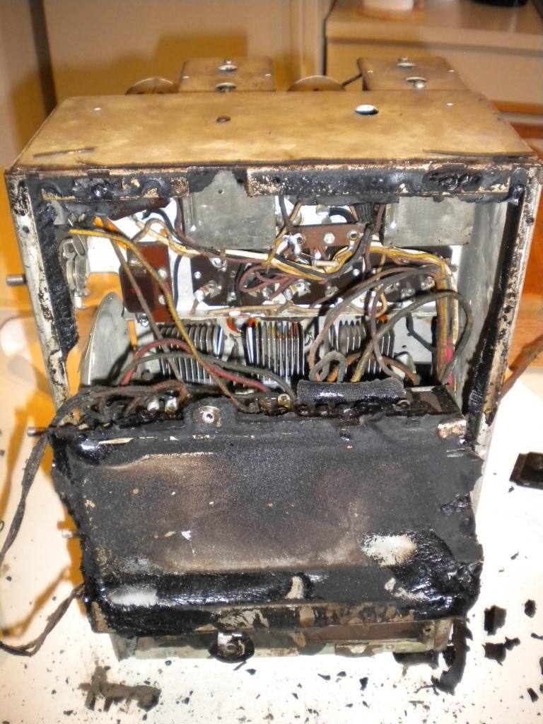

Here are some pictures of Majestic model 20 clock radio that I fixed for a friend a few years ago. It had some melted tar issues.
Some signs of melted tar when I pulled the chassis from the cabinet:
Bottom of the chassis:
The surprise hiding inside. I finally got the bottom cover off with a heat gun:
It turns out that the filter capacitor bank had overheated. All of the tar like potting material around the capacitors had leaked out into the bottom of the chassis. This radio actually sounded pretty good when I was done, but it wasn't simple to rebuild.

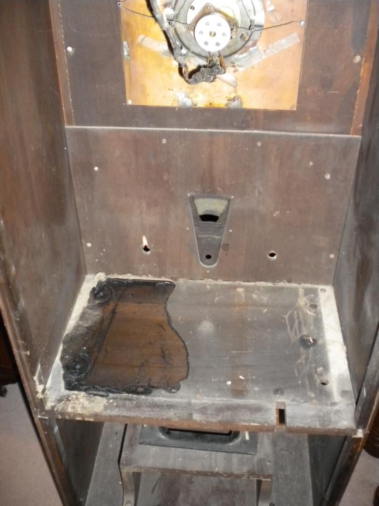

Had to look through my archives, looks like this was in the March 2015 issue of Nuts & Volts Magazine
chaz's picture of the mouse nest, Rocco53's picture of the juice can coil shield, and I did use your picture of the AK 55 lava flow it looks like. (I also used two of my own photos, a Simplex Model P which had both missing and extra parts, and a 1931 Westinghouse grandfather clock which caught on fire.)
