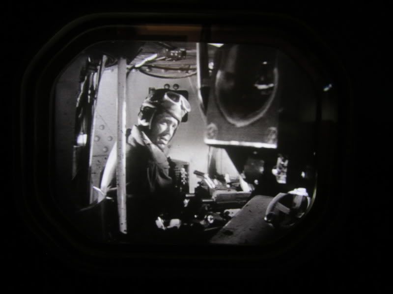

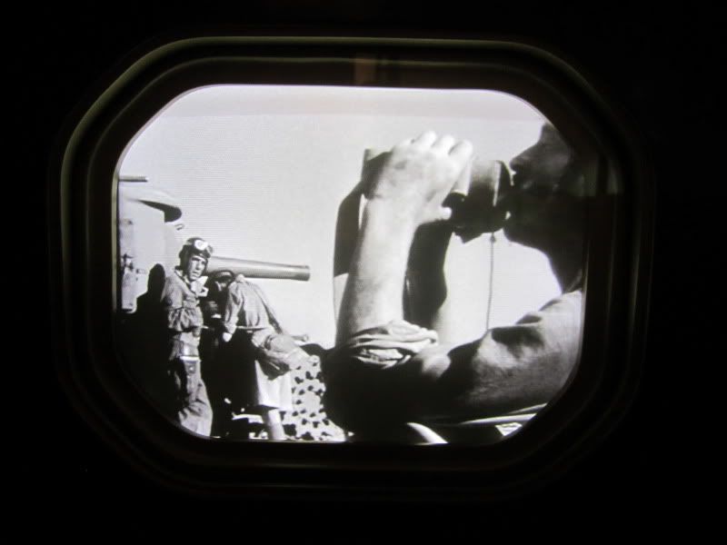

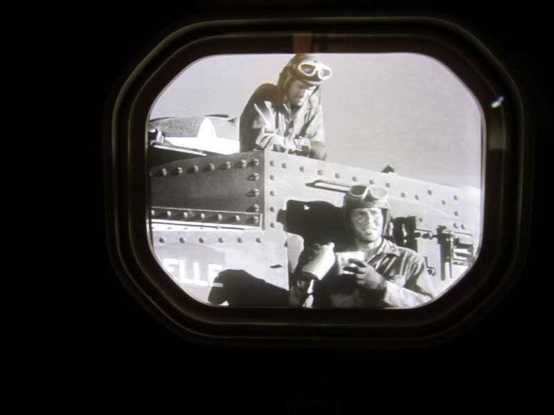

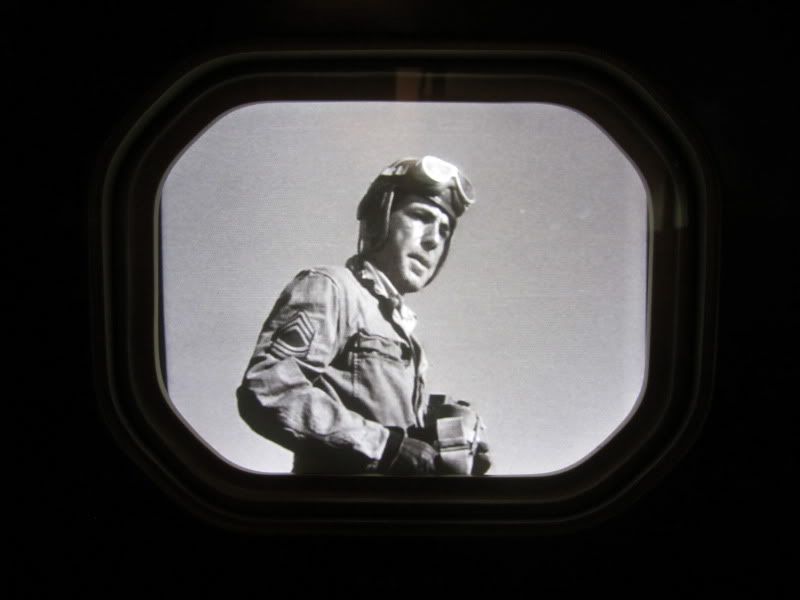

Left the TCS on for three hours without a signal and blew the flyback, a 47pF Mica in the Horizontal Freq, and a 2 watt resistor. The resistor saved the rest of the chassis by blowing itself up.
Bob, a friend of Henri and myself, troubleshot the chassis, and replaced the aforementioned parts. He suggested I replace all the micas in the Horizontal Locking, Drive and Frequency circuits, and I did that.
Seems to run just fine now...

Today I'm going to take the TCS's little brother, the 721-TS tabletop model, down into the lab and replace all the micas in the horizontal circuits.
It looks like from now on we should replace all horizontal circuit Micas as a matter of routine - just like Tubulars and Electrolytics. The Experts here are right. They really take a beating, and in the sets I'm working on, are over 60 years old. They probably led to the flyback getting wiped out.

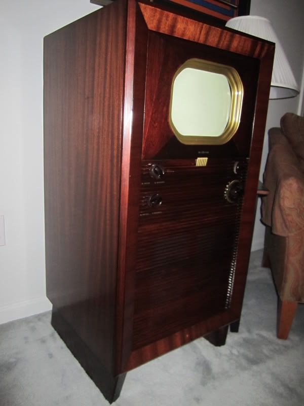

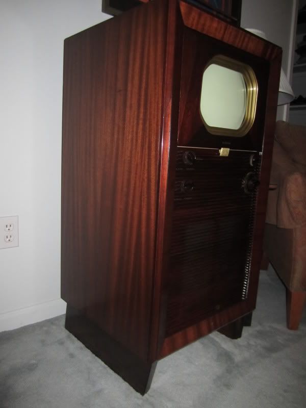

Nice set Phil. Walnut, right?
Mine came complete with the back screen. It is identical to the tabletop model 721TS, which is repro'ed, BTW. Those tapered, slotted round head wood screws that secure it are available, in brass, at Home Depot in bags of six. I spray them satin black.
I think you're going to like it. It's my favorite set at present. After the recent repairs it has a sparkling good pic, and even the sound is good. The tall cabinet positions the CRT for easy, across the room viewing.
It's an easy electronic resto. Considering your cabinet is in good condition you should have an easy time of it overall.

Yeah, it simply failed. Whether it had a signal or not was academic.
Good things came out of it. Before it crapped out, it had minor horizontal "issues." Little lines and snaps. Repaired, with all new Mica caps in the horizontal section, it's a cleaner, better performing TV.
So is it's little bro, the TS... 8)
