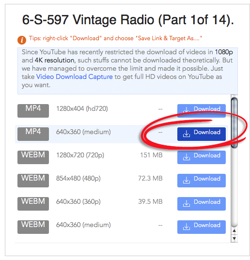

Check-out John Kopp's youtube channel, user name 'joernone'. John has done quite a few repair and restoration series.
Watch: Part one of 14. 1941 Zenith Model 6-S-597
http://www.youtube.com/watch?v=SuKWqPjd6gc
John is known here on Arf as 'badrestorer' ... one of life's good guys.
To save videos for later viewing, use→ https://www.apowersoft.com/online-video-downloader
Save MP4 at (480p)
Just copy + paste the youtube video URL into the download box... avoid the advertisements (cleverly named Download) and the offer to download/install their desktop version.
Rename your downloaded file to end with→ .mp4
