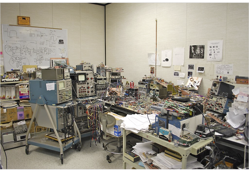

Edit: If you're a disorganized right-brainer, like a few folks around here... :). then this is where you'll end up!
The late Jim Williams' bench. (Linear Technology Corp).
https://www.eetimes.com/document.asp?doc_id=1259711
