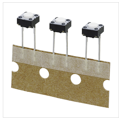

An added momentary switch + dial-lamp modification is also discussed here…
http://www.davidmoisan.org/radio/supera ... app_A.html
Google…
momentary push switch - - or - - tactile switch
