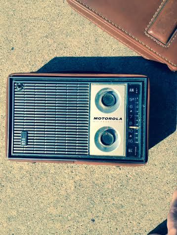

Hi John,
After seeing the great job that you did I decided that it was about time that I worked on my Motorola X31 that has been sitting in my attic.
The first thing that I noticed was that the front panel was bulging out on the left side and also the volume control was not centered properly. I looked inside and all of the PCB and battery mounting screws were present and were tight.
Since you completely removed your front panel on your radio I was wondering if you could give me any advice on what I should check next ?
Frank

 Post subject: Re: 2nd Motorola X31A-1 another "challenge"...
PostPosted: Sep Fri 11, 2020 4:19 pm
Posts: 6580
Location: Indianapolis, IN
Hey Frank, haven't heard from you in awhile !
There is a heavy press-board liner inside the leather cabinet which the front panel is attached to. I've had one come loose (glued in place) and had to re-glue it. Best that you remove chassis to attempt this so that it could be properly place in position after applying glue. Think I used Elmers Carpenter's wood glue which I had on hand. Also good to carefully clamp it using small pieces of wood (or something similar) to protect surfaces.
You could look at another thread which shows radio disassembled to see how it comes apart.
Good luck and let us know how it goes !
PostPosted: Sep Fri 11, 2020 8:14 pm
Posts: 6580
Hey Frank---it doesn't have to be wood glue, that's just what I had at the time. Just something that would bond that press-board to the similar material of leather-covered shell...
PostPosted: Sep Fri 11, 2020 8:27 pm
Posts: 36212
Elmer's white glue works well on this type of material.
