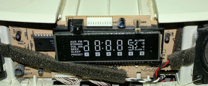

Had to make a run to Fry's electronics tonight (I did not have enough 47uf caps), but I finished recapping the main board and equalizer.
This is the second one of these that I have found. This information is for the Generation 1 Bose wave Radio, the other radios have different circuit boards.
I was very careful and only broke one trace, but I did mess up about 4 pads and had to do some "fancy" soldering. I double checked the polarity of all the caps (fixed one) and powered it up. It works just fine. The next step is to recap the display board.
To get to the display board, use a small screw driver in the 4 square holes on the bottom of the main case.
You will then be able to remove the front cover.
To remove the control panel, carefully pry up on the back of the panel and when it is about 1/4" pulled up, hold the display board in place and push the control panel forward to unplug it.
To get the panel out, pull the speaker wires partially up through the hole in the case, the panel will tilt forward and can be removed. There are no screws in it, but there are 2 pegs that fit in holes on the circuit board.
Code:
Electrolytic caps in the display board
2 - 1uf 50v
1 - 4.7uf 35v
2 - 47uf 16v
1 - 220uf 6.3v
All the caps on the display board are very short so mounting replacements can be a problem. They can only stick up as high as the display, so some may have to be bent over.
Make sure to clean the green plastic lens as it will usually be filthy.

I recapped the display board except for the 2 - 47uf 16v caps, as I did not get enough of them from Fry's last night, and the ones they have, would not fit between the board and the face plate.
I am not too worried about it as there is no capacitor juice on the board so I probably did not need to replace any of the display board caps. I will replace the 47uf's at some point later on.
Recapping the display board and cleaning the lens did not make much of a difference on the display brightness, so either it won't get any brighter or the 2 - 47uf caps might help, I don't know at this point.

The flourescent display may have low emission. They lose brightness with continued use, not unlike that of an eye tube.

Well I thought so as well, but when I moved it to the bedroom, it was comparable to the other one I have, I think my bench light that made it look dim.
