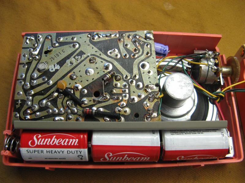

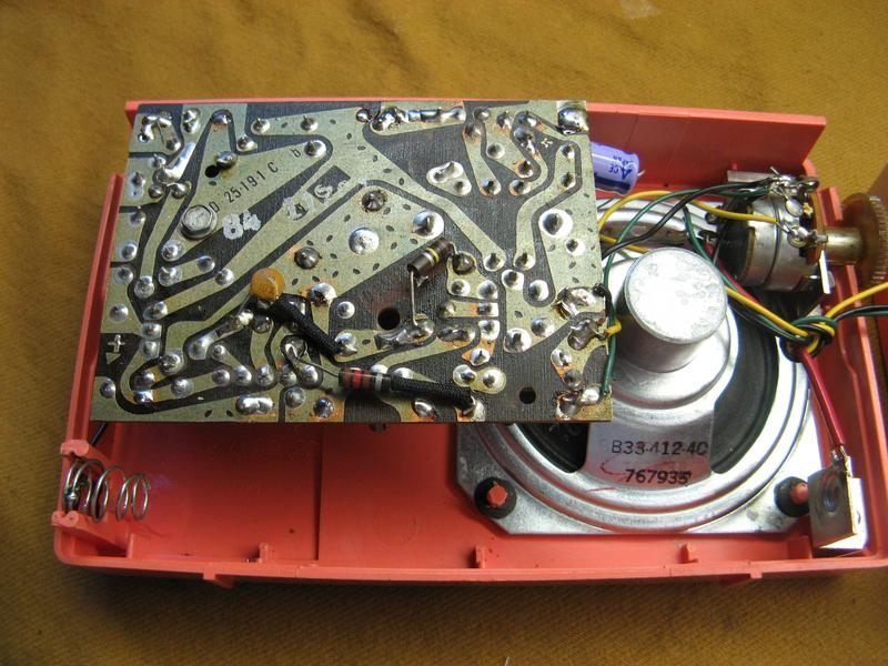

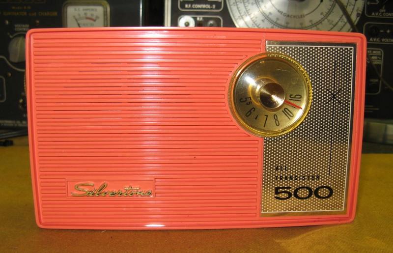

Bought this cutie around a month ago. Seven by four inches tall, approx same size as GE P805 through P809 series.
As far as durability, ruggedness is not one of it's strong suits. Chassis balances on a pair of mounting posts and with back removed, only one screw holds it in place(visible left center). Screw to secure back also holds chassis and mounts through opening near the pair of resistors. The resistors are part of a feedback circuit in IF that was a afterthought, early versions do not have these parts. Audio is interesting, uses a pair of outputs in PP but is driven by 2nd IF that is also fed detected audio. Speaker is capacitively coupled, has no output xformer. .
Batteries mount in a trough only lays in place, upper supported by chassis and cabinet holds lower edge.

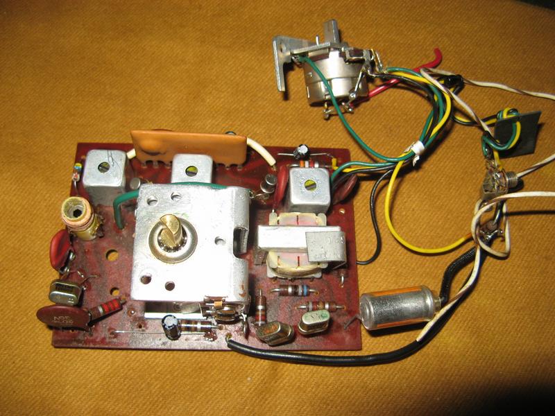

Chassis, missing antenna that's approx 3" long. Pict of second parts chassis. Size somewhat minimized by use of couplet and fact it has no output transformer. The GE P80x chassis is almost double in size and those have tuner remotely mounted.
This pict is actually orig chassis from this radio. The parts radio chassis is now installed(first three pict). Orig has either a bad osc coil and/or bad 1st IF transformer. Osc would drop out at approx 1400 & return around 1000. I changed EVERY part in osc circuit incl transistor twice, no help. Also the 1st IF would not align, could get no peak, second & third peak nicely.

Interesting that it uses a Couplate; I'm not sure I've seen them used, outside of toob sets.
Is this a 5 Transistor? That's all I see, and might explain the lack of oompf W/O an audio driver. Have you tried using a nine volt battery to see if you get better volume?

Yes it has five transistors.
It has more than enough volume, will play quite loudly. On orig chassis, I did run voltage up a maybe 7v to see how osc recatected, no help.
I believe it's biggest downfall is fact it uses a "little finger" size antenna, even after alignment, only plays strongly by rotating to pick up best signal.

That could be, but remember, Japanese vertical sets by and large used short antenna ferrite rods as well, and had very good sensitivity. Might just be that the Germanium converter and IF Transistors are pooped out by now.
Remember there are two radios. For the pictured bare chassis, I replaced all three of front end transistors with ECG replacements, zero difference. The installed chassis works well enough and as Rocco says, it will be a shelf queen.

It was listed in catalog for three years('60-'62). I suspect rarity is more likely due to, drop it on a hard surface and you had a double handful of pieces. At least the chassis supports were history, when broken allows works and batteries to float around inside. This is issue with cabinet of 2nd radio. Someone drilled holes front and back, then installed screws through the set. Quick & dirty repair but does serve purpose. I also suspect this one died early in life and was relegated to someone's dresser drawer. Evidence of previous service, someone had been in inside, wiring removed and resoldered. Problem was the reflex transistor (2nd IF/1st audio) was shorted.
Rocco53 wrote:
That is a nice looking radio Tom, love the color.
Colin Ames wrote:
That’s a nice looking radio. I like the color.
Thanks guys!
Unusual COLOR is what lured me into the rabbit hole, that led to buying a 2nd parts radio.

As promised in the other Silvertone 500 thread, I took another look at this Coral version & checked it's distortion level.
viewtopic.php?f=4&t=367001
It's actually good, though reflex IF/1st audio amp can easily over drive PP outputs. Biggest issue is 4.5v is apparently not enough B+. Following Richard's lead, I upped to 6v and the little guy comes alive. Volume increased noticeably before distortion set in.

If those two 820Ω resistors are used for each output Transistors base bias, you might fiddle with the values to see if you can convert the distortion into a higher, clear volume level. The increased voltage producing distortion would indicate that a change is needed.
