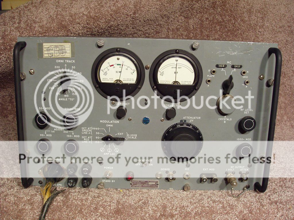

Nova-Tech
Man I forgot all about those guys. As you said, they made really CHEEP stuff. If you ever find a need for a Narco VHT-3 manual I've got one, and an early mark 12 manual as well.
I had a display of old pull outs from Narco, Nova-Tech, aerotron, aero-ear, Lear, and others, in the display cases when I had the avionics shop. When FAA said all com/nav had to be TSO'd lots of stuff came outta the woods.
The last relic from the shop I sold a couple years ago. Why I hung on to the thing for 50 years I'll never know.
EDIT: replaced pic, only did it using Smugmug.com as source.
