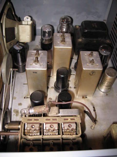

Hi All, I picked one of these up this weekend and I was curious to see if the date of manufacture could be determined by the serial number. The serial number on mine is 210 2024. This one is nice and clean too. :D

That looks nice and clean Doug. The NC-57 was a pretty effective performer in its day and price range which was one step above the AA-5 variety.
One way to approximate the age is to see if the filter can has a date code. Another is to find a manual on BAMA or elsewhere that has a manual with the 210 production run # on the back page. It will have a code with month and year of that runs release such as 352.

Hi Carl, I looked on the back cover of the manual that came with the unit and the code was ??1-4000-9-47. I couldn't read the first two numbers. Under that number was ER-210, so this would appear to be Sep 1947. Correct?

Yep, Engineering Run 210 Sept 1947. National put a bit more effort into the front end than Halli and it shows. And since they made their own IF assemblies they didnt buy the cheapest (widest) ones in a vendor bidding war.
