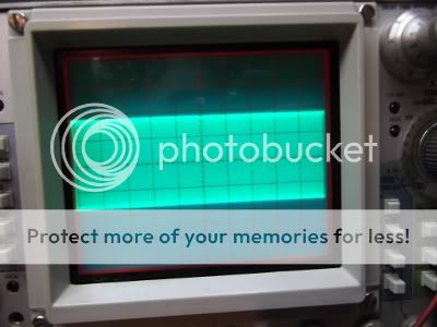

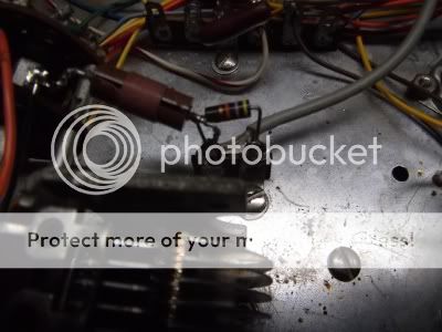

A breakthrough this morning- on the advice of 2 or 3 of you guys, I finally got around to measuring R6, the PA grid leak resistor. Bingo! I've found the culprit. R6 was way high out of range at about 193K ohms, should be 47K. Well, I have literally hundreds of this value 1/2W carbon comps, NOS. Popped a new one in and now I see no LF oscillation at any setting of the Driver Tune cap.
Thanks for all the great help, guys! I'm not the best troubleshooter. Eventually I fumble my way through. Still plenty to do before I'm finished with this radio, but I think it will be all downhill from here.
The grid leak resistor is at the far end of a short piece of shielded wire coming from the PA, next to L5 and C30,
the Driver Tune cap. The original resistor is seen high out of spec on the DMM.
A clean looking sinusoid at ~7010KHz, shown at .05us/div, 0.5us/div, and 5us/div.

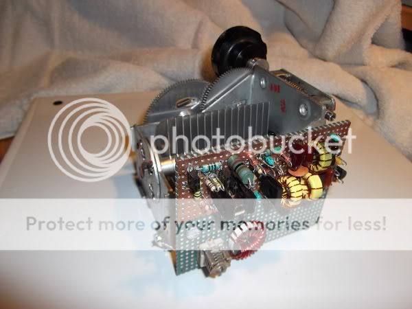

The original three electrolytics including the yellow one seen topside in this view have all been replaced with modern parts.
I'd like to get a few critical on-air reports on the CW note, but it sounds pretty good in my receiver. Cathode keying generally sounds pretty nice.
This working 40m VFO project needs to be completed and then this will be a truly usable setup on the bands. Running with crystals is a real pain. I have a nice, compact cabinet for it that's just the right size. Snug, just enough room for various additional electronics in the back. A little sheet metal work, a simple amplifier circuit to bring the output voltage swing up enough to drive the grid of a vacuum tube- and I'm good to go... I'll get it done one of these days soon, since that VFO is also needed for a couple other projects also underway.

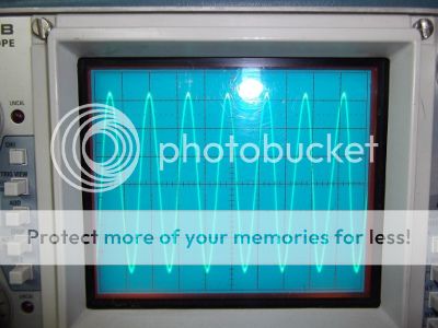

OK, I got a few photos of the waveforms last night. Let me say up front that the measured PERIODS of all these waveforms imply the fundamental frequencies are correct for the appropriate band settings, i.e. I do get 7, 14, or 21MHz as appropriate. I believe the settings for all photos were 50ns/div and 20V/div.
20 meters with Driver Tuning adjusted carefully, 'spot on'. It looks clean.

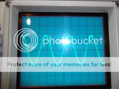

20m with Drive Tune mis-adjusted. Depending on which side the cap
is set, either some of each alternating positive or negative peak is
'missing' (but not both at the same time). This is seen with only
slight mis-tuning of the knob. The setting for a 'perfect'
sinusoid is very touchy. Note that this differs greatly from 40m
where the waveform remains quite clean with any mis-tuning to
either side of the peak.

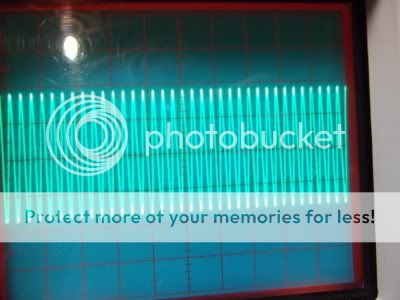

15 meters- the scope has trouble syncing to this waveform.

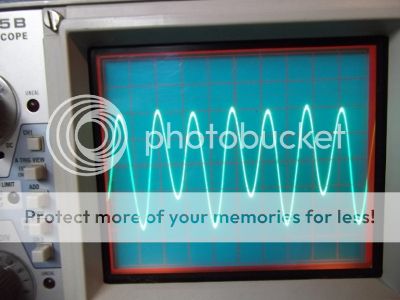

15m- Mistuned (Driver Tuning quite high, like half mesh).
A variety of different waveforms can be seen as the Driver
Tuning is rotated. At all times the fundamental remains 21MHz,
apparently.
I don't think I'm seeing a low freq relaxation oscillation at work here as before, but perhaps it's happening just the same. It now looks to be nothing like what I saw when the PA grid leak resistance was way too high.
My next move is to add some resistive suppression here and there, as Carl suggested, and see what that does...
Maybe I AM seeing an "every third cycle thing" on 15, Curtis. It's kind of punching me in the eye, isn't it? (last photo)

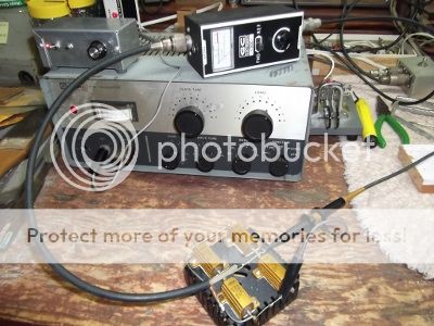

P.S. Here is a photo showing where I'm sampling the waveform. 10x probe across the dummy load, which is four NHG-200 non- inductive resistors in parallel on a stamped type TO-3 heatsink. Any potential measurement errors with this setup? I figure the high impedance of the probe is not affecting the impedance the transmitter sees- much(?) I know, I ought to have a proper pickoff circuit in a shielded box...

Earlier today I corrected the grounding problem with the 10pF cap across the PA grid. Verified that it indeed measures 10pF out of circuit. I also added a 22 ohm 1/2W carbon comp in series with the shielded lead, right at the grid pin. I also replaced the PS output cap with a series string of modern electrolytics with 105K RN-60 type equalizing resistors. Old value was 20uF 600V, new string is 90uF 750V. I also replaced the green 6m/10m tap wire and the orange 80m tap wire going between the tank coil and the band switch under chassis.
None of these changes has made any observable difference in the 40/20/15m output waveforms. I'll keep at it. There is still plenty more to check.
I'm wondering if I might be causing any measuring artifacts by improper scope lead setup, perhaps some sort of a ground loop? Will think about some alternative ways of making the measurement. But it still looks marginal on 20m and the waveform is just funky on 15m. Still looks very nice on 40m.
In addition to adding snubbing in the screen lead to the PA, I need to re-verify that the screen voltage is right. Believe it was, though. Do indeed need to take a slow and very thorough look at the wiring sequence per the manual instructions, since such extensive 'shotgun style' wiring changes have been seen under chassis.
I kind of wondered.
I knew the Heathkit DX-60 design did something that I thought the T-60 might also do.
For the DX-60, the HG-10 VFO for 20, 15, and 10 was actually always operating in the 7 MHz range and depended on the driver stage being tuned to a multiple of the oscillator (i.e., 2X, 3X, 4X) to drive the final at either 14, 21, or 28 MHz.
I believe that is why you are seeing the every other cycle thing on 20 (X2 frequency multiplcation), and every 3rd cycle on 15 (3X frequency multiplcation). Essentially the oscillator kicks the driver in the seat of the pants and it then rings at the appropriate harmonic for an extra cycle, two cycles, or three cycles until the next kick in the pants.
I am suspecting that might be completely normal for the point where you are monitoring the signal.
At the output there will be additional suppression of all except the desired signal by the final stage tuned circuit match into the antenna.

I have both admiration and sympathy for those working to stabilize and behavior-sanitize the Knight T-60, the electrical design of which is a variation of the design used in the Hallicrafters HT-40. It's a electrical design with built-in problems--its final is non neutralized, and high-L driver-to-final tuning/coupling design only tunes through an in-band peak by luck--but at least the mechanical design of the HT-40 is RF-literate. From an RF engineering standpoint, the T-60's signal flow v mechanical flow is crazy. Output-network and driver-to-final tuned circuit switching are combined in one compact bandswitch, with the switch many inches away from both parts of the circuit it serves. Side-by-side solenoidal coils in that bandswitch can and do intercouple to weird effect. The crystal socket is many inches away from its associated oscillator/driver tube, requiring that both leads to the crystal cross the cable between the final and its grid tuned circuit. The oscillator driver tube--unshielded until modifications were made after many T-60s were in the field--is only about 3 inches away from the output-network coil, making the "RF gozinta" couple directly to the RF "gozouta."
It's as if an early sketch of a layout done by an audio guy was put into production by mistake: The rig's AF tubes start right at the front panel and head straight to the final amplifier in a nice, tight line, whereas the oscillator/driver tube is far from the front panel, which is to say "everything it should be close to"!
I just picked up a beat up, obviously dropped T-60 on Ebay for $30, and rebuilding it in an RF-literate way--and adding 30 meters somehow--will be the second big clutch of tasks. The first task cluster will be to make it work like it did out of the box so I can feel all the pain inflicted by its bad design.
To that point, however, I do have some suggestions that may help those trying to kill squegging and low-frequency parasitics in their T-60s (and any other transmitter that may harbor them). The first thing to try--and leave in place even if it doesn't work--is to add a 100-ohm carbon comp or carbon film resistor between the 6DQ6's screen terminal and the outside world. That's right: Neither the screen feed wire nor the screen bypass capacitor should connect directly to the screen terminal. The reason this change is necessary is that beam power tubes, especially beam power tubes designed for use as TV horizontal-sweep amplifiers, are prone to oscillations caused by the screen exhibiting negative resistance when the plate voltage dips below the screen voltage (as will be the case when the tube is putting out anything like design-maximum power as an RF amplifier). That negative resistance can cause oscillation if a suitable LC or RC circuit is connected to it. Adding a low positive resistance in series with the negative resistance works against that tendency. (I recommend also adding a 470-ohm resistor between the screen bypass and the screen power-feed line, as this will help the bypass do its job.)
I present an evolving writeup about this effect; web-search for "David Newkirk" and "negative resistance" and you'll be able to jump right to it. Screen and/or plate negative resistance is why the 807 drove RF folk nuts for decades with pops and clicks on CW and splatter and distortion on AM. There's even a reference to killing 40-meters-destroying key clicks from a T-60... :-)
Returning to the T-60, two more things:
Because the T-60's 6DQ6 final is not neutralized and because the set's mechanical design is so RF-illiterate, the final may operate as a locked oscillator--locked, that is, to the signal from the crystal oscillator. (If you can pull out the crystal and still see RF power output, there's your proof. Wrote George Grammer, W1DF, in his review of the T-60 in May 1962 QST: "The 7-Mc. oscillation was only observed when the amplifier was lightly loaded and crystal was pulled out, but on 3.5 Mc. the crystal had a hard time getting control under any condition of final-amplifier loading.") This is the cause of the hysteresis (output peak occurring at different TUNE/LOAD settings when tuning upward and tuning downward) and output-power jumps users of the T-60 (and the HT-40, BTW) experience. Allied's later modifications included additional shielding and adding a 27-k resistor across the 6HF8 pentode's plate RF choke, and these may help, but I'd go with the fix described by Grammer: Solder a 22-k resistor across L2, and solder a 4.7-k resistor across L1.
If the 100-ohm 6DQ6-screen stopper resistor doesn't do away with the set's low-frequency parasitics, leave that fix in place--really--and then also try adding 220- or 470-ohm resistors in series with one or both of the 5-mH chokes associated with the 6HF8 pentode driver. The 6HF8 pentode is a high-transconductance tube, and installing same-value RF chokes in the grid and plate of such a tube sets the stage for tuned-plate, tuned-grid oscillation. A few hundred ohms in series with either or both chokes should sufficiently reduce their Q such that oscillation cannot occur. The effect of those resistors won't be much at dc, and therefore they should not affect the oscillator/drivers' ability to oscillate and drive. :-) Adding just such resistors cured just such an LF oscillation in the 12HL7 driver stage in a homemade transmitter of mine some years back.
