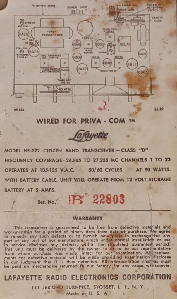

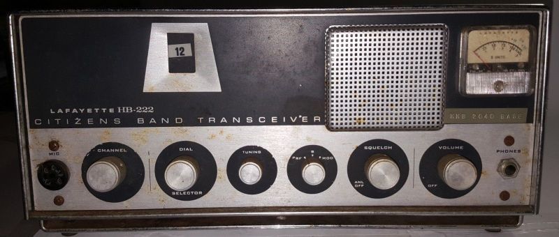

I somewhat impulsively bought what I thought is a too cool old cb radio on ebay just yesterday. It was advertised as
"working". Smile.
[url][URL=http://s372.photobucket.com/user/langgatruck/media/front%20of%20hb-222.jpg.html]Image[/url][/url]

The HB-222 was Lafayette's first 23 channel CB transceiver. Since I was there when it was introduced in October 1963 (for the 1964 Main Catalog), the fact was it had some severe design problems in the crystal mixing scheme and alignment for both the transmitter and receiver. It was not uncommon for the HB-222 to transmit perfectly on some channel, and then after some short period of time, when the transmitter was keyed, transmit on some frequency completely different. Receiving was also somewhat erratic with strange non-CB signals popping up on various channels. Almost very transceiver was returned with the same issue. By roughly January/February 64, any units in stock were returned to the main warehouse in Syosset, NY never to be seen again.
Lafayette quickly made a deal with Hammarlund to re-brand the Hammarlund CB-23 to Lafayette HB-266. The HB-266 was then used as a replacement for anyone wanting to buy a HB-222. When the 1965 Main Catalog was introduced in the Fall of !964, the HB-222 was gone for good. The Lafayette HB-333, 23 channel transceiver made by Polycomm, had center stage, and there also was the introduction of the first imported Lafayette 23 channel transceiver, HB-400.
Maybe the HB-222, after 50 plus years, killed off all its bad stuff, and now works better. :D

And By the way manualman it sounds as if you remember these early lafayette radios and I wonder about the microphone plug. My radio comes without microphone and from the picture it appears to take a 5 pin mike. Not the typical DIN style 5 pins but 4 pins grouped together in the circumference and then the 5th pin opposite the 4.
I can replace the receptacle to a more common one but would rather find the correct plug.

Mike plug is Amphenol 91MPM5L. Haven't been made in years but stock still floats around.
If you want to buy one:
https://www.tedss.com/91MPM5L
I would have to check ny HB-222 documentation but most of the Lafayette CB's that used this mike plug/jack, only used 4 of the pins (pins 1, 2, 3, 4)
