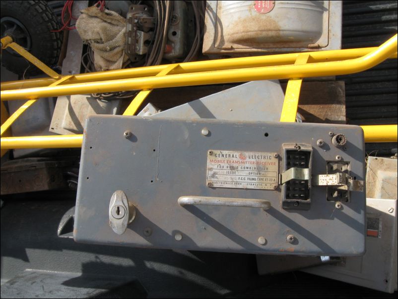

Hi all, My brother in law asked me if I wanted his dad's old 2 way Motorola radio set up. He didn't send any pics and I was expecting something CB sized under the dash and a base station at home. The unit for the car weighs around 50 lbs on it's own!!! AND the base station weighs in at around 150 lbs and takes 2 strong people just to carry it. The antennas are missing along with the harness to plug in the car unit, but they could be replicated easily.
Million dollar question... Does any of this stuff have any value?? Would be colossally expensive to ship I would imagine.
Opinions please. Does have a massive transformer if you're into that kind of stuff. Here's the pics...

This is not frequency agile. Plus does it work on the low band [30 to 50 mhz] or high band [150 to 170 mhz] ?
But no mater, was probably last used maybe 30 years ago, needs a full recap. Maintenance nightmare
The power supply is valuable to a select group.
Bring it to a hamfest $100 OBO [or best offer] or start at $200 and keep dropping it.
and drop the price down by every 30 minutes [and say so too]
You want somebody else to haul it away.

If that is a rack case sell it and part out the rest... As stated conversion to anything Ham is just way too much. Should be some good iron there designed for 24/7 operation. May be a few audio small signal tubes as well...

These things were "valuable" fifty to 60 years ago because they were being taken out of commercial service, which made them cheap. So hams made use of them.
But soon after, there was a wave of solid state gear specifically aimed at hams. More expensive than surplus, but small and light.
Even that's now "obsolete", replaced by equipment with built in synthesizers.
Even if you wanted to use a big and heavy tube rig, you'd have to find crystals for that rig.

The base stations that were originally on 30-36 and 42-50 MHz are still useful to sit on the national simplex frequency in that you only need one channel. As in 29.6 and 52.525 . Of course lately with the demise of International Crystal and the breathtaking prices of the surviving crystal manufacturer in the USA, we have to rummage overseas for somewhat reasonably priced crystals. The mobile units have a modest demand among people restoring old police cars.

There are a few people who restore vintage emergency vehicles, or build replicas of them using period correct vehicles, that would pay quite nicely to get a clean mobile unit with the correct original mike. They are looking for cosmetically clean units that would have originally been in use in the era of their vehicle. I've seen them go for as much as a few hundred $$$ to the right buyer.
The base unit is only good for parts but someone will buy the rack cabinet.

Anyway, that mobile unit looks to be in great condition, as does the base. Most are pretty beat up. I would keep it!
