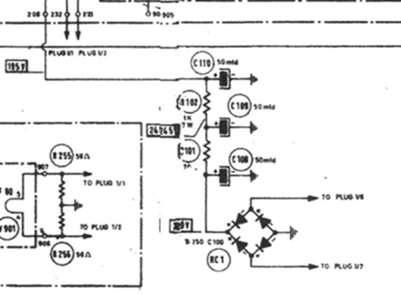

I'm working on a Telefunken Opus Studio 5650.
The Full wave bridge is shorted out. I'm wondering about the 5 pin array on the bridge. I've never come across a full wave bridge with more than 4 pins. The two outboard pins on the part (see image below) are marked as negatives on the casing. The schematic (also shown below) does not indicate the extra negative connection. There is no continuity between the two negative pins. I've looked up the datasheet online for a B250C100 bridge and all the sheets I've checked show the usual 4-pin array.
Anyone have any input ?

Diodes are in a row and may require two negatives to be connected together? If 4 diodes are wired together in a bridge diodes at each end need to be connected together. With an external connection no internal wiring will cross.
Norm

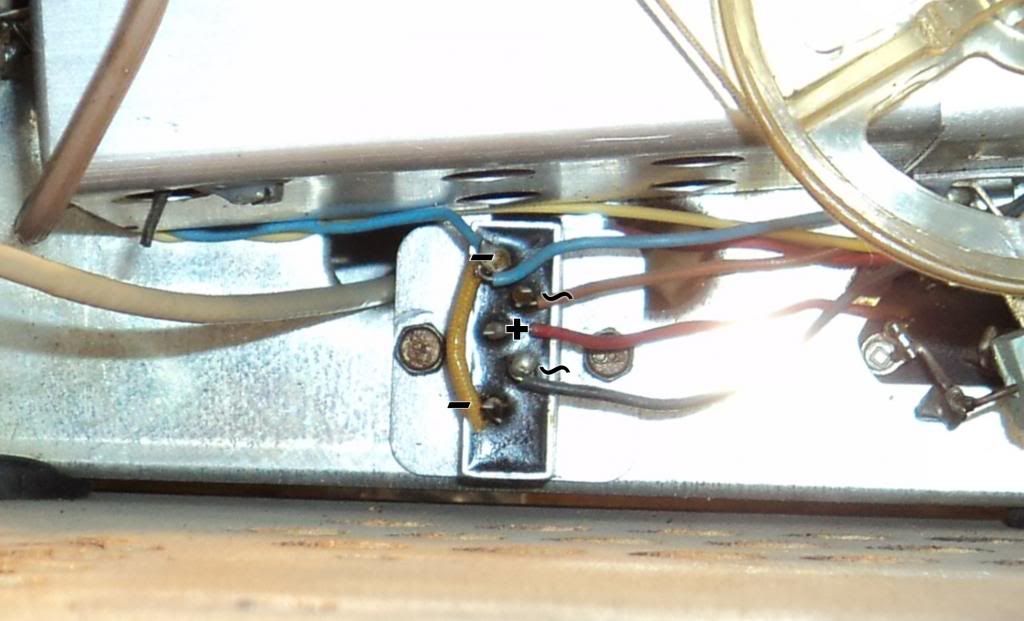

Here is a photo of the original installation connections of the 5 pin bridge in the Telefunken. There was an exterior jumper wire connecting the two negative pins (yellow wire).
I would be interested in seeing a schematic diagram of the 5 pin bridge.
I'm also curious as to why the manufacturer would even use such a component as opposed to a standard 4 pin bridge (which is what I plan to replace the shorted bridge with).
I expect procurement got a good deal on these, possibly surplus from some other company.
The two separate negative outputs probably result from lack of space inside the package to connect the two ends.
- Leigh

Those are not uncommon, I have seen a number of them over the years in various devices. I think the earlier comment is correct, it was just easier for them to manufacture the bridge with two separate negative terminals. They are always jumpered together upon installation.

I believe the 5 lead issue has to do with internal construction. Most bridges are made by connecting the leads of separate diodes, like 1N400x series.
If you make the bridge such that the leads emerge from one of the large flat faces of the housing, you need only solder the connections and use the excess lead length as the bridge's external "pins." If the package is "in-line" (that is leads emerging from one of the small faces), then an internal jumper is needed so that the diode leads can be used as pins. To save money, maybe Siemens decided to let the customer provide the external jumper?
At least, this is how we made molded bridges at Westinghouse.
Larger bridges that use "fast-on" lugs could be made with all the lugs facing up and the separate chips soldered between internal metal tabs. These are much better for current-handling and heatsinking, but not as cheap to make as just twisting and potting 1N400x or 1N540x individual diodes.
