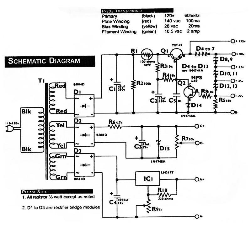

I am trying to wire this radio to a ces pine board power supply. I understand the A power
will have to be reduced to 2 volts. This supply has A+,A-, B-, (B+ in +22,+45,+67,+90,+135) and
C-,C+. My question is how can one wire go to C+ and B-, and Two different wires for
C- 3v and C- 9v. How do I wire that to a single C- on the power supply.
I used one of these power supplies on a old Atwater Kent. Battery radio and everything
came out fine.
I attached the schematic.

If I understand this right I can use my power supply for the A+,A- (2v) and
The +90 (B+), +135 (B+). With nothing connected to the B- on the power
Supply. Then use 3v batteries in series as shown above for the 3 and 9 volts (c)?

Connect B- and C+ to this blue line shown on the schematic.
Burdawg wrote: Just replace the 50k (R7) pot with a voltage divider network of 6.8k, 13k, and 30k (in that order) wired in series from the c+ terminal to the low side of the c supply. The network will still be about 50k so the load on the c supply will be about the same. Connect the c+ terminal to b- to reference the c supply to b-. Then you will have -3v at the junction of the 6.8k and 13k resistors, and -9v at the junction of the 13k and 30k resistors, referenced to c+. I said earlier that I also had -12v but forgot that I eliminated that to make it simpler. You could always play around with the values to get other c voltages if needed.<BR>Remember to disconnect that 900ohm resistor or it will load the supply and the voltages won't be right.

I tried using the CES power supply for A-,A+ (set at 2 volts),B+ 135v and 90v, C- (set at 3 volts), a 9v battery for
The -9v connected to C+,B- (black wire, white trace) and C- (Green wire). I jumpered C+ And B-.
So far I can’t even get the tubes to light up. I read somewhere on this site that this radio has
To have a good electrolytic so I started recapping tonight.
Thanks for the help.

The tubes lighting up should be pretty independent of everything else. Note that they normally don't get real bright. (Turn out the room lights in order to be sure of seeing the filaments.)
What was your A voltage at the tubes? You do want to set that before connecting the radio to the power supply, since the A supply can be set far too high for the tube filaments.
If your power supply is to be used only with this radio, it might be good to add a fixed resistor across the A voltage adjustment pot to limit the maximum to something like 2.25V.
Another mod to the A supply might be a dropping resistor ahead of the filter capacitor. This would reduce the power the regulator has to handle. An ohm or so might be about right.
It might be a good idea to add series string of diodes across the A terminals in the radio to limit overvoltage. Four regular 1A or 3A diodes in series, or three regular plus one shottky diode.
If I understand the radio schematic, the 9V C minus input is loaded by the 900 ohm resistor, so a high impedance source won't work for that voltage.
I have to ask, why did Philco do that? They even provide switch contacts to turn off the load resistor when the set is off. The only reason that comes to mind is it would increase sales of C batteries. I wonder if the 900 ohm resistor might safely be disconnected.
You will want to verify all the "battery" voltages at points inside the radio.

Did you Remove the 900Ω resistor?
as mentioned here→ viewtopic.php?p=261456#p261456
You need to remove R7 (the 50K pot) completely, and replace it with the three resistors in series, as recommended by Burdawg, and pick up your -3V and -9V from their connections.

What is the wattage on these resistors?
 Post subject: Re: Philco 37-38
PostPosted: Apr Wed 10, 2019 9:41 pm
Posts: 11479
As noted on the schematic - - Use 1/2W resistors.

There should be about 10mW dissipated by all three resistors together. So you could use 50mV, 30V parts, that come in the 0201 package.
However, it might be better to choose something with leads that's big enough to see, rather than just big enough electrically. Something like 1/4 or 1/2 watt would be fine.

I guess 1/4 watts won’t work. I have box full of them in all size. I don’t have 1/2 watts.
I may have to order some. Can a 15k be used in place of a 13k?
PostPosted: Apr Wed 10, 2019 11:58 pm
Posts: 11479
Just clip them together and take a few measurements. The 1/4W will be OK.
The value of the resistor determines the Voltage drop across it.
The values given are probably on-the-money.
Experiment and see what you get... :)
