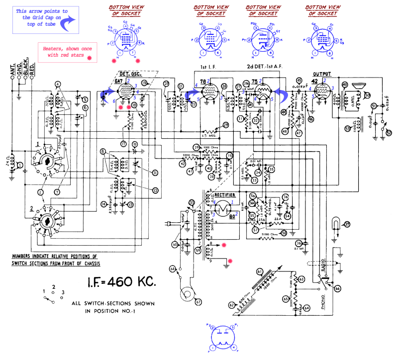

 Post subject: Re: Magnavox CP 252M
PostPosted: Apr Sat 04, 2020 12:02 am
Posts: 15268
All of the tube's (pinouts) pin numbers are identified on the schematic above for...
MAGNAVOX AMP142AB
The corresponding leads are numbered one to nine around the tube's circular diagram perimeters.
pins 2 and 7 are the filament/heaters connections - - Y and Z on this schematic.
Their leads/schematic lines are omitted from the drawing for clarity. Their origin Y and Z can be seen at the power transformer T1
They also connect to the AM-FM Tuner Power Socket - - pins 2 and 4
The schematic representation of 12AX7 is "split-in-two" on the schematic, again for clarity.
From the tube pin numbers...
You will now be able to identify/follow their pathways into the circuit, and the components that are connected to them.
Viewed from below - - bottom view of sockets aka tube bases. lol
Large image→ https://a4.pbase.com/o10/56/215056/1/16 ... titled.png
A few different (tube bases) examples are shown above, but... no doubt you get the idea... :)
oh... label the wires (both ends) with marked-up masking tape flags, as you familiarize yourself with the circuit.
Edit: 12AX7 has a center tapped filament
pins 4 - 9 - 5

Nanofards are not used too much around these parts, that why I apologized for the French on-line calculator.
Stick to microfarads and picofarads.
call it 0.1μF (microfarad)
To answer your question... I have no idea... :shock:
is it from your amp?
or... is it from your tuner?
what was it connected to?
The Voltage rating of a capacitor is how much Juice that it can handle - this can be increased.
Some of the old μF (microfard) values are no longer common... so choose the next nearest capacitance value, up or down.
Sal has 0.01μF axial film capacitors for peanuts.
http://www.tuberadios.com/capacitors
.01uf @ 630v.........25/$6.25.....10/$2.75.....1 for $0.30
He is a forum sponsor, and can be found on the right/hand side of this very page → → →
