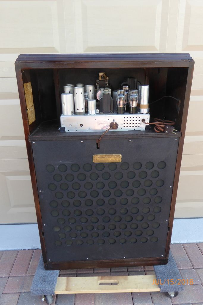

I made this out of automotive door panel backing that I bought from an auto upholstry shop. Proper thickness. color all the way through, water resistant, and didn't fray or seperate when I drilled it with a 1 1/4" hole cutter.

It looks factory made. Excellent workmanship.

Thank you. Just thought you might want to see what the front of the radio looks like. (Off topic)

I can see a van off to the left, almost read the van's lettering...
So much can be said about re-finishing, bringing out the color, the marquetry and veneer accents is what it is all about...
Often OEM's covered all beauty of the wood with a dark tinted lacquer...
Chas
Smith's Ale Gives Strength, Smith Bros. Brewers, New Bedford MA
 Post subject: Re: Radio back replacement?
PostPosted: Oct Mon 22, 2018 6:22 pm
Posts: 33292
That radio looks incredible, front and back! I could comb the few hairs I have left just looking at the reflection off of it... :wink:
