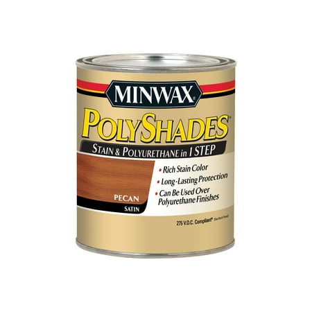

ARRRGGHHH! OK, so I stained the corner trim with a darker color, and the sides and front with a somewhat lighter one. The sides came out ticketyboo (as the other English speaking world would say), but the front and top; I used exactly the same stain, the Minwax in the larger can, and it came out dark, as you can see. Now of course I can sand it down and do it over, but I don't want the same results. Why doesn't it stain the same color as the sides, or what do I have to do?
Guidance, please.

Thx for your thoughts, Gary. I guess I wasn't clear enough; I want the front and top to look like the sides, i.e., a lighter finish. I assumed that the type of wood was the same for both, but do you think that's not the case, and the reason why the front and top stained differently?
Here's what I used;
The smaller can of wood finish is what I used on the corner trim, and although the color looks similar to the side, it's actually darker, giving a nice contrast.
Richard

The front and top are walnut. The sides are not.
Normally you'd pick a toner color -- Perfect Brown is a good one -- and use it on the front/top and the sides. A light spray on each surface would probably get them close to the same. You want a dye-based toner that won't obliterate the grain. Stain just isn't a good solution for this. You never know how well it will absorb and whatever shows on the can probably isn't going to be what it actually looks like.
The trim, as others have said, should also be toned (after masking), but instead, use a pigment-based toner to darken quickly and hide any grain.
I'd say you've compounded the issue by using a stain/poly mix. Those products are great for someone who has an oak shelf they want to finish, or any project where the object is made of all the same wood. For your radio, the best thing to do is stick with lacquer. Lacquer is really easy to remove if you goof something up.
Next steps? I guess you could strip the polyshades off and start over..
Peter

Would not have used the PolyShades. What works for me is a Mineral Spirits based stain. Look on the can and see if it says it can be thinned with that and works for clean up. Might have said I start with a thinned mix 50/50 maybe and apply after grain filling, with a lint free cloth. Can always go for a stronger mix later if needed.
