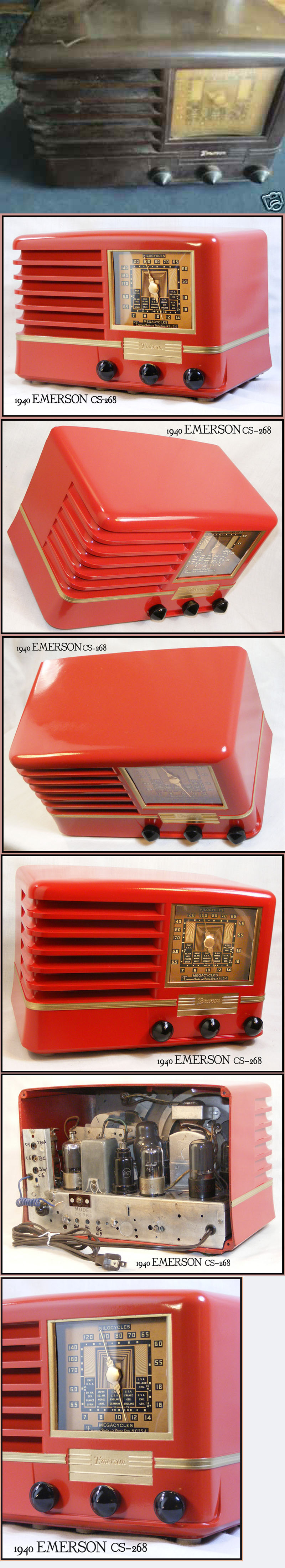

Peter, I saw you have the Traveler and a 1940 Emerson on eBay. They look fantastic. You should do very well with them. How did you paint the Emerson I would like to do one like it.
PostPosted: May Sat 30, 2009 3:54 am
Posts: 22613
Well..lol.. I said to my friend who does the painting... please paint it using period colors .. try to stay consistent with the dial colors too.. and "red" is a typical favorite!..
And he came back with this!..
So he did it.. not me..lol
The red is sooo friggen beautiful though!
It's a candy apple that really looks like glass... almost looks translucent.
The guy is a genius.. but I cannot take ANY personal credit for the work.. only the ideas.

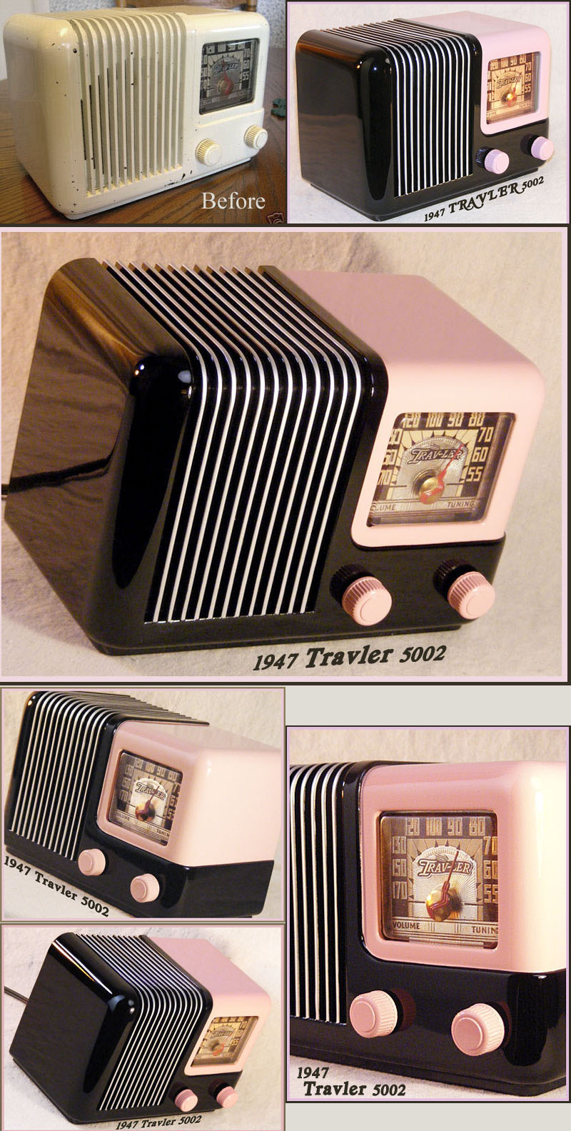

pbpix,
I've got to comment on a little something that struck me about your pictures of your finished pictures.
You put the year and model of the radio in text underneath the radio in your pictures. You must use Photoshop or some other similar software to skew the lettering to match the ortho views of the radio. I own a digital imaging business and work with images like this many times daily.
It's just a little thing but it's a little touch that I immediately noticed and adds alot to the image. Well done.
dave
PostPosted: Jul Thu 23, 2009 2:36 am
Posts: 22613
thetexan wrote:
pbpix,
dave
Wow thanks Dave:
Yes that's what I use.
I have a background in the computer support services for several graphics arts and magazine pre-press houses... so that's where I developed an appreciation for those aesthetics.
