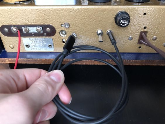

I added an audio jack so it can be connected to an iPod or iPhone:

An astounding result and your step by step photo documentation will help many of us with future veneer challenges. Which wood filler product did you use? I've tried several and they don't seem to level the grain as desired and generally don't accept stain readily.
Please consider a separate post to provide detail for your audio input jack. Very nice work and welcome to the forum!

I actually listen to this radio on a near daily basis. The audio input makes these radios far more usable. It is my favorite way to listen to podcasts. I just have to find a podcast on youtube and plug it into the back of the radio.
This video explains how an audio input can be added very easily. I just followed his instructions.
https://www.youtube.com/watch?v=j8YeJ0T3DpI&t=2s

Rather than use a switch with a simple jack, as shown in that video, it is easier to use a switching jack, as shown in the Peter's thread on this site. I've done it quite a few times and it works well. It is even better if you use shielded two wire cable between the volume control and the jack. Here is Peter's thread: viewtopic.php?t=116118

I’ll consider using a switching jack for my next project. I wasn’t able to find a switching jack for stereo when I was working on this set, so I just used a toggle switch. I find that the switch is easier to use without pulling the radio from the wall than plugging in a cord. I suppose the main benefit of a switching jack is that it is more discreet.
