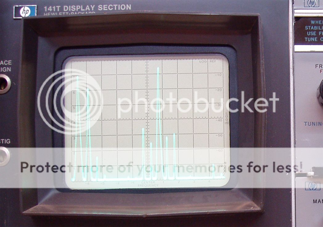

Just for grins I checked the output levels of several generators and my counter, into a 50 ohm input on my scope. With the exception of the 3336 all are fairly nice sin waves.
Model.........Freq..........RMS level
HP3586.....10Mc...........500mV
HP5245M...5Mc.............1V
HP8660.....10Mc............770mV
HP8657.....10Mc............420mV
HP3336.....1Mc.............750mV P-P Sq wave
Also hooked up a MCL SRA-1 with the 5Mc LO from the 5245M counter optimized for best loss/spur levels, and a 5.5Mc signal at 0dbm. Conversion loss about 9db and close in spurs at -40db or so.
First spike is "0", second is IF out 500kc away, 5Mc lo is about mid screen at about +4db.
