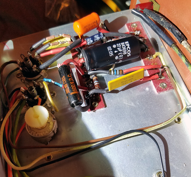

I have finished checking and replacing components on the bottom of the TO-6A that needed to go. I am almost ready to test it!
Here is a shot from my cell camera of one half:
Full Size: https://www1.picturepush.com/photo/a/15 ... stored.jpg
Note: I found an error on my labeled schematic, R6 should be 500k ohm, not 560k ohm.

That black .005/600v capacitor with the orange markings sure doesn't look like a part that I would trust.

Have you measured those carbon comp resistors? I would have put in films. I see you did in a few spots. Did you stay with the same dissipation rating? Or figure out the sharing to know the series resistors you put in will work? And I would change that .005 as well.
