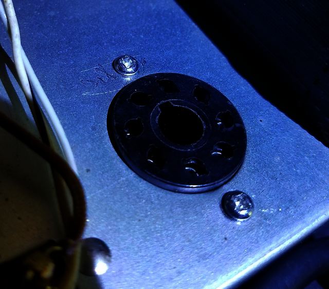

I wiped the meter down as advised and it did move somewhat back towards 0, I believe it is sitting about half way between 0 and 1 now. I am still going to remove it to see if the adjustment is misaligned.
I finally fixed the 6BL7GTA socket, the rivets gave way and the socket pushed into the hole when I was reinstalling the tube. So I drilled out the rivets and put in some standard bolts and nuts. I added a drop of glue on both threads so the nut doesn't walk off.
So I can finally put the tubes back in and check the voltages suggested earlier in the thread!
Also here is a full shot of the bottom after repairs/replacement parts:
Full Size: https://www1.picturepush.com/photo/a/16 ... 056-sm.png
