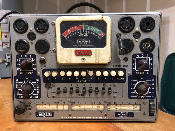

I'm going to pickup a well used Jackson Tube Tester Model 715 from a Craigslist buy. What do you look out for when you get a used tube tester? Any tests to perform like dim bulb testing? Any threads exist that cover the basics?
edit: seller has no documentation on the device.

I would not get any tube tester unless set-up data and other information was available for it.
That tester looks like it hasn't been taken care of very well; the meter is cracked and the shorts neon lamps is missing or pushed in. Does it have the cover?

I wouldn’t buy that one unless you know the meter is good or you really get it cheap. I’d also want to take a look inside and make sure the switches are not corroded

It was cheap and the gent who sold it gave the family history: "Dad was a ham and EE, these have been in the shed since he died 15 years ago. I used to test my amp tubes on this.". I know there is a pithy Latin phrase for that story ...

All that may well be true. But the meter shell is broken, and if it was "in the shed" for decades, you'd better hope the shed was indoors and dry. :)
At any rate, it'll be a nice project as long as you have patience

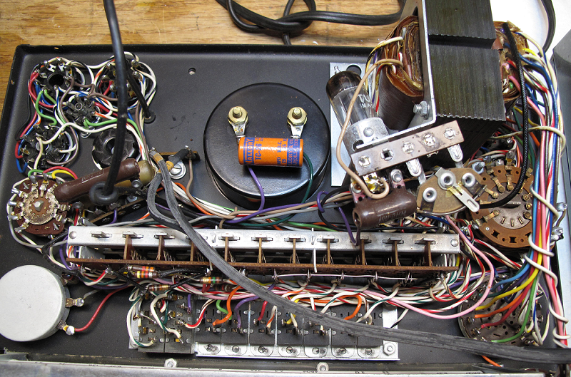

Inside nothing weird visually - meter looks sound, a few crusty bits around the transformer wires, but nothing huge jumps out, all the switches seem fine, no green contacts.

Ordered the 25 mfd 25 V cap which is across the meter - I don't see any mention of that in the 561 or 115 schematics I have, any clue why it is there? It tested at 56 uf, shows no leaking, but its out of spec.
The C1 cap also was off (.50 uf) and replaced with a .1 uf 640V.
I've replaced all the carbon resistors, some were going high, others were just funky looking. I left the two Tru-Ohm brown ceramics (R1 and R2) in place, they tested OK.
Some housekeeping, cleaning up with IPA and DE-OXIT seems to have restored the feel in the push buttons and other switches.
While I wait for the 25 uf cap, I'll get the 6C4 to another tester and see how it is.

The cap across the meter is close enough for you to start playing with the tube tester, as-is. It won't change the operation or readings. It was probably a factory change, but possibly someone just added it. It has the effect of "damping" the meter a bit .... in other words, basically slows down the action. It will smooth out any oscillating voltage, and provide a bit of damping. In a nutshell, changes the ballistics slightly.

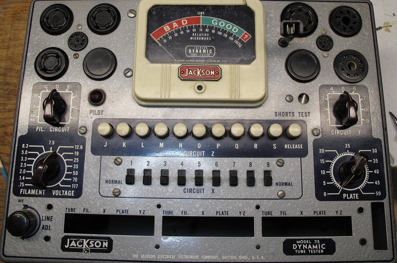

It cleaned up nicely ...
It came up on the variac, the meter works, pilot light is good, neon responded when I flipped the Y circuit between 2 and 3. Meter has a jitter, so the 25uf cap will go back on when it arrives. Meter also comes up above center then settles down to center after warming up.
So far, so good, thanks everyone! Me and the manual tonight ... :)

Lookin' good .... it's always nice when you clean one of these and it looks new-ish. You never really know whats lurking under decades of crud.

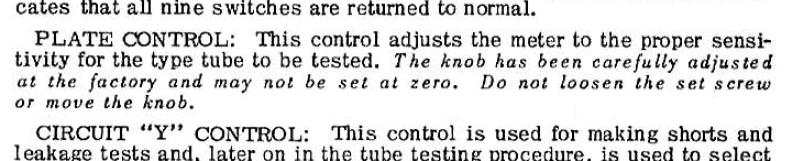

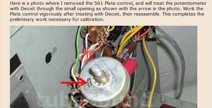

OK - don't know if this is critical or not but I was following the reconditioning steps outlined at tubesound's blog ; https://tubesound.com/jackson-561-tube-tester/ and they recommend this:
When I reassembled, set the pot to full left and then aligned the dial to zero.
Then I read this in the 561 manual (the text in italic worries me):
Anything to worry about? If so, any idea how to tell if its out of whack?
Sheesh - John

Well, for one thing, the tubesound article says he sprayed Deoxit into the semi-sealed potentiometer. Bad idea. Spraying something into a potentiometer that has no way for extra stuff to get out, or evaporate properly, is asking for trouble.
Without making negative comments about any one in particular, it's always a good idea to gather MANY opinions on how to do something with 70 year old equipment, before doing it. On the internet, there is likely to be a lot more bad information, than good. Sometimes it's well intentioned but just wrong, sometimes you'll get someone wanting to show off how much they think they know.
That potentiometer in your tester may or may not have even needed cleaning. Sometimes just exercising it a few times is sufficient. But if cleaning were necessary, I'd have opened the pot to do so. Hopefully you'll be OK and haven't introduced any stray leakage into the system.
As far as the dial calibration, I've not personally worked with this tester. Hopefully someone has. But, do you have access to the manual? It may list the calibration procedures there.

The only manual found so far is for the 115, the older brother to the 715, the above is a quote from that doc. At least we've flagged that pot cleaning issue so others won't run into it. Seems the 715 is a bit of a rare bird and while there are similarities between these in this product line, I'm thinking each is a little different, why else would Jackson reissue a new model?
Good news is that I've tested 5 mini's, one was bad and four had tested good bad (per another tester) and the results matched.
I'm going to pull down some other socket types and see how they compare to previous testing.
So, on we go - this has already answered one question about a 1S5 which was worrying me, now at least I can eliminate it from the potential problems, nice!
